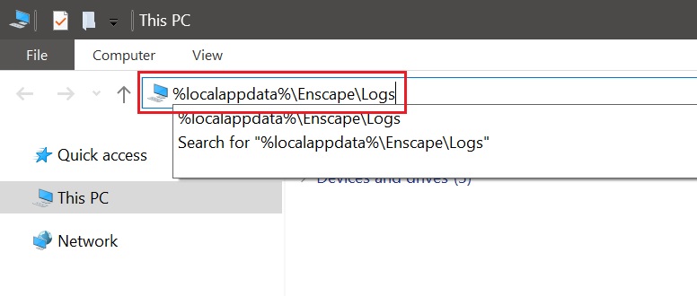

1. First, you'll need to navigate to the directory where they are stored. The easiest way is to copy and paste the following path in your Windows Explorer - %localappdata%\Enscape\Logs
2. The next step is to select all of the folders in that directory and zip them.

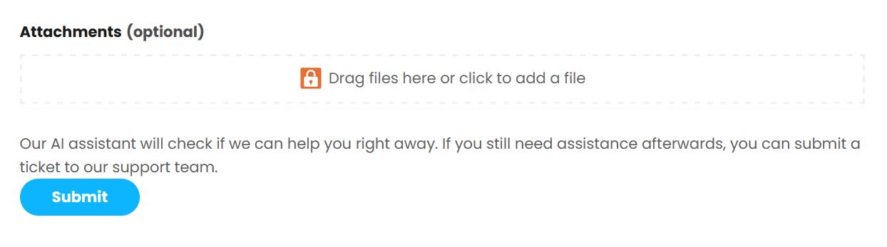

3. Finally, when creating a ticket through the Chaos Help Center > 'Contact Support', you have the option to add attachments to your support request. Upload the zip file you created and submit your request.
