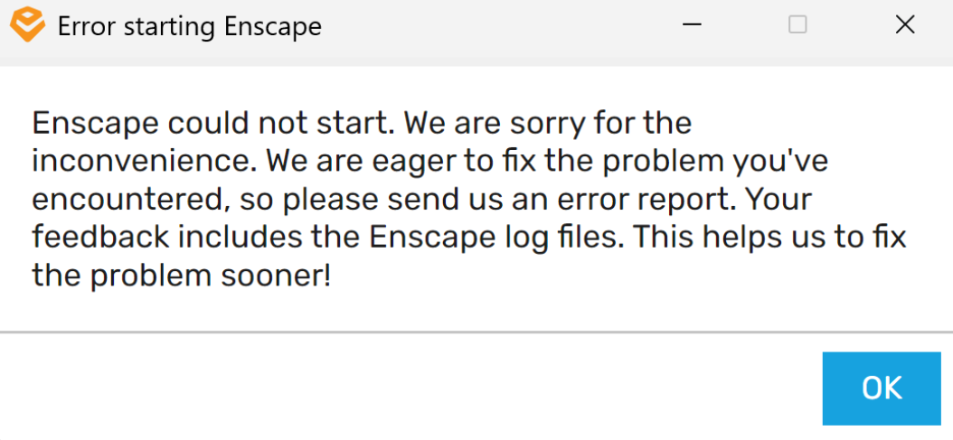

Typically, the error says:
"Error starting Enscape
Enscape could not start. We are sorry for the inconvenience. We are eager to fix the problem you've encountered, so please send us an error report. Your feedback includes the Enscape log files. This helps us to fix the problem sooner!"
