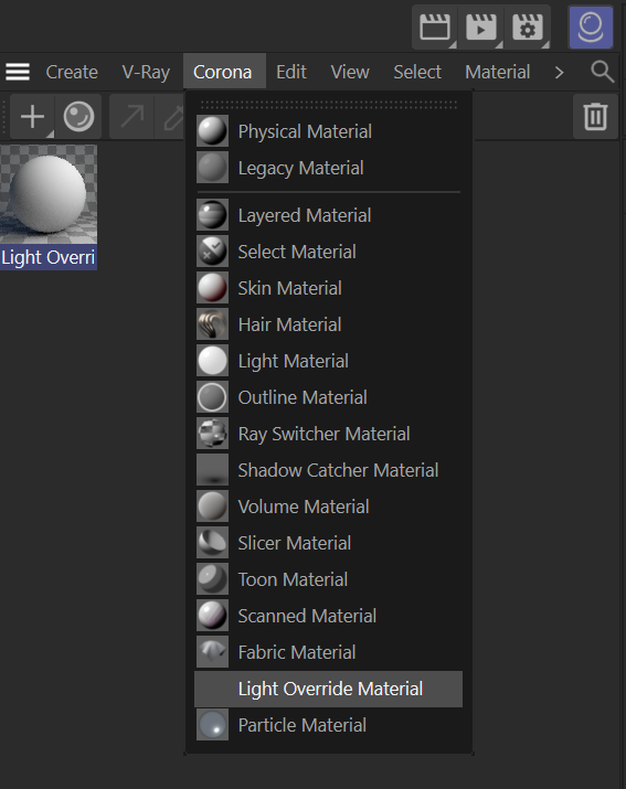

In Cinema 4D, the material is available from:
Material Manager > Corona > Light Override Material

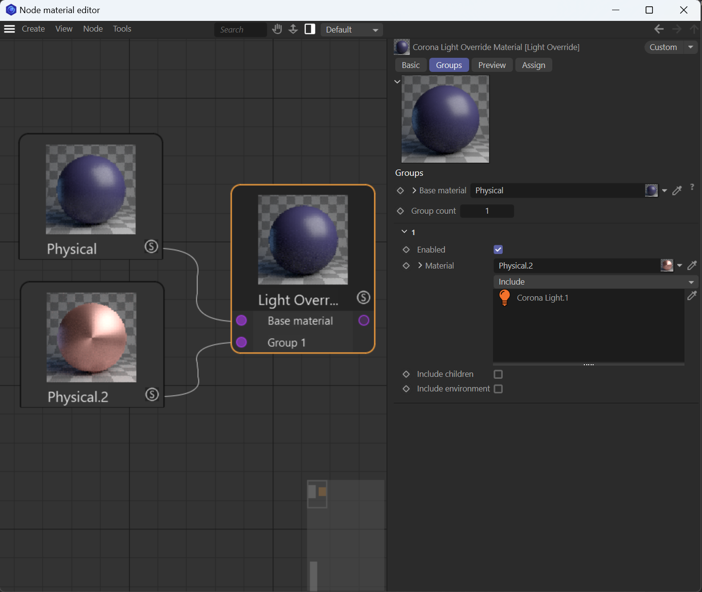

  1. Open the Material Manager.
  2. Go to Material Manager > Corona > Light Override Material

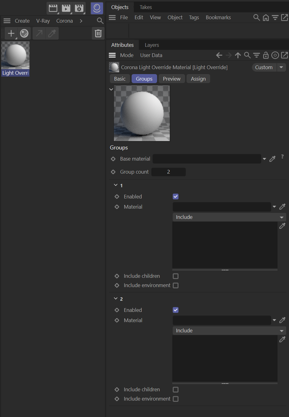

  3. Assign your base material to the Base material input.
  4. Set the required Group count.
  5. Add a material for each group.
  6. Add the lights that should control each group.
  7. Assign the final Light Override Material to the object.
Base material
Defines the main material of the object. This is the default material used when no light override group applies. In most cases, this should be the regular material of the object.
Group Count
Controls how many light override groups are available.
For example:
  • Group count 2 creates two override groups.
  • Group count 3 creates three override groups.
Each group can have its own material and light include list.
Enabled: Turns each group on or off.
When enabled, the group can affect the material using its assigned lights. When disabled, the group is ignored.
Material
Defines the override material used by that group.
For example:
  • Group 1 can use a Red material.
  • Group 2 can use a Green material.
  • Group 3 can use a Yellow material.
Each material is triggered only by the lights added to that group.
Include
Defines which lights trigger the override group. Only the lights added to this list will use the material assigned to the group's Material field.
Include children
Includes child objects of the lights added to the Include list.
Include environment
Includes environment lighting in the override group. Enable this only when the environment should also use the override material.

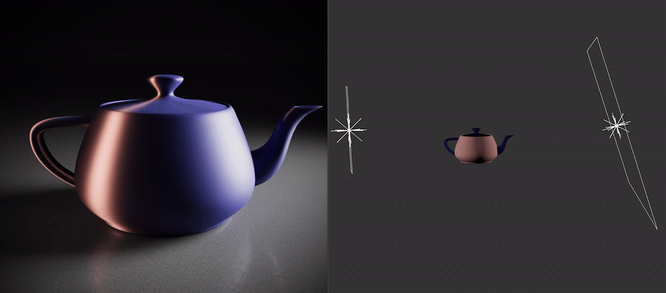

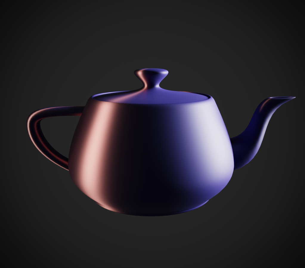

Example 1:
In this example, the Corona Light Override Material is used on a teapot. The teapot keeps its regular blue material as the base material, while a second warm pink material is revealed only when the selected override light affects the object.
This means the same teapot can show two different materials depending on the direction of light.
Material setup
The setup uses the following materials and nodes:

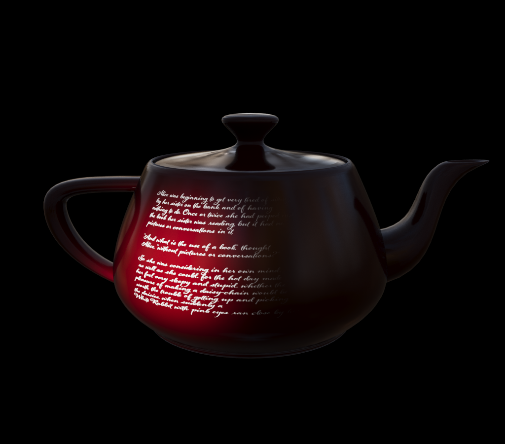

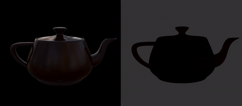

Example 2:
In this example, the Corona Light Override Material is used to reveal text on the teapot only when a specific light affects it. The teapot uses a dark red material as its normal appearance, while the override material adds bright text using a bitmap mask.
When the included light illuminates the teapot, the text becomes visible on the surface.

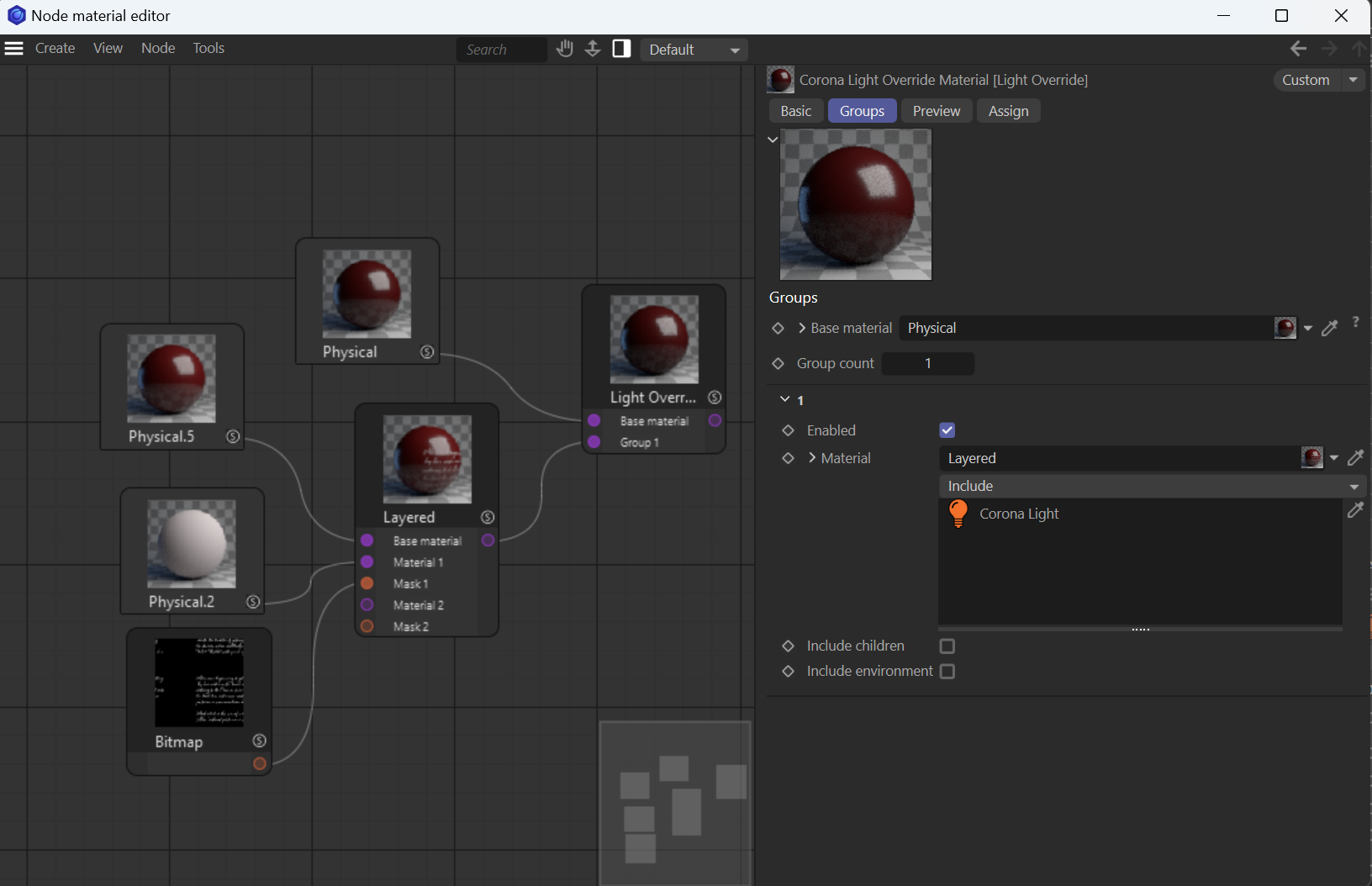

Material setup
