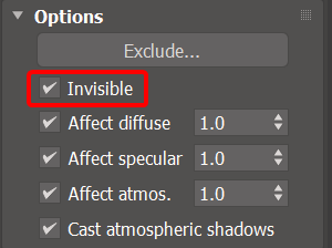

    • Enable V-Ray Sun's "invisible" option
Preview of the VRaySun's invisible option in 3ds Max
