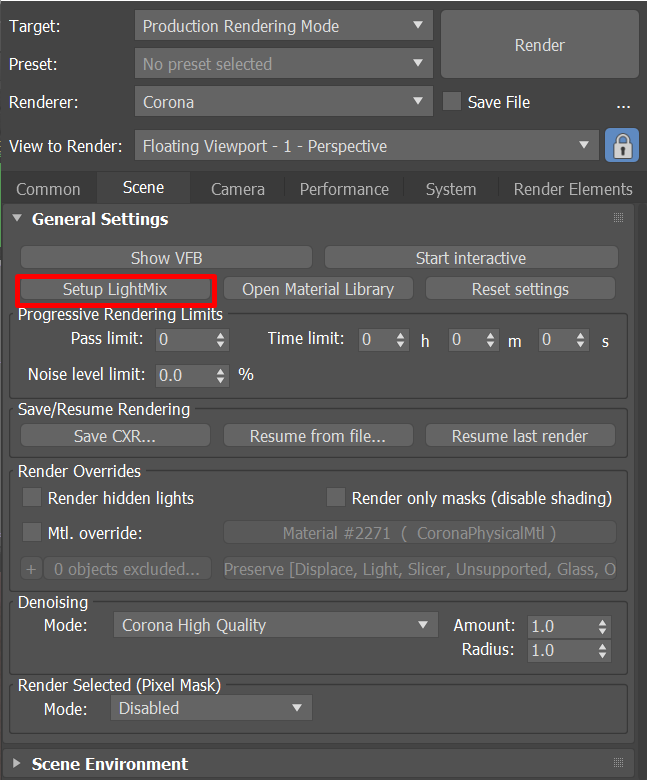

- Use "Setup LightMix Elements" button in Render Setup > System > System Settings to automatically create LightMix elements based on all scene light groups (this will automatically get rid of any duplicates)
(click to enlarge)
