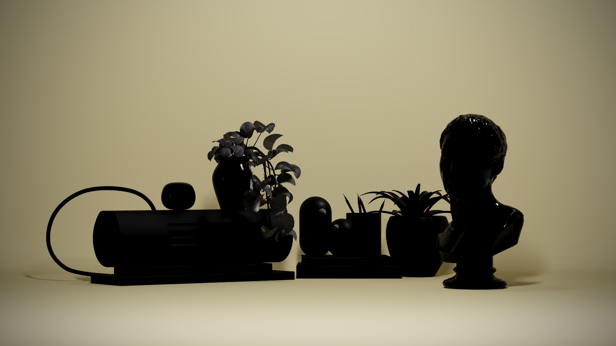

1. Fresnel IOR = 1.1
Pure black diffuse color:

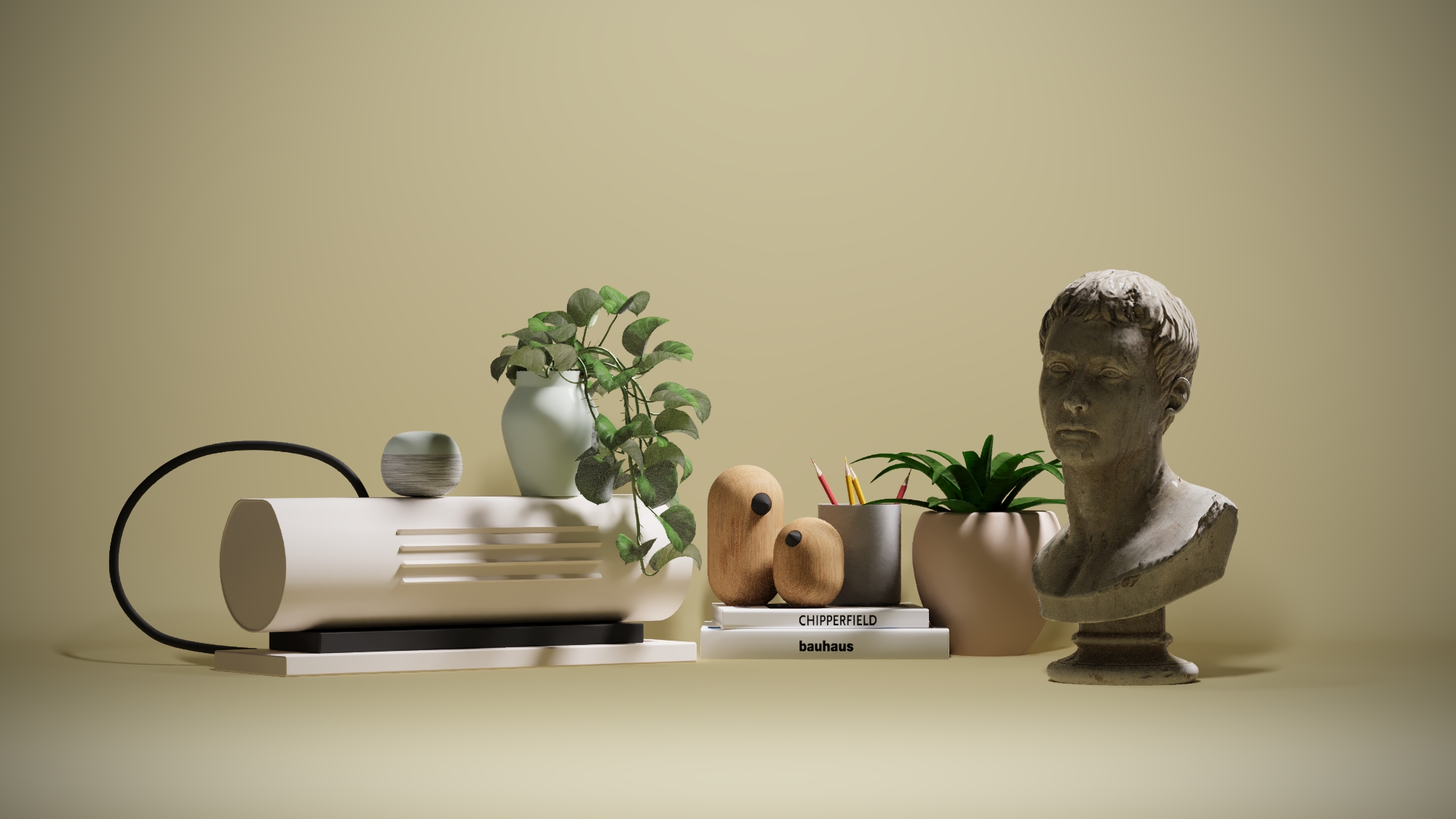

With diffuse color:

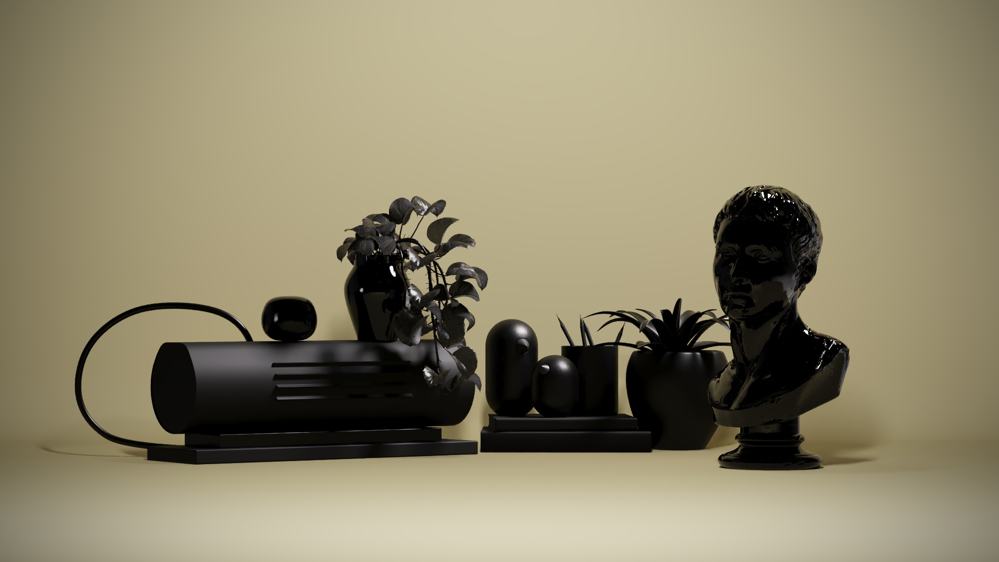

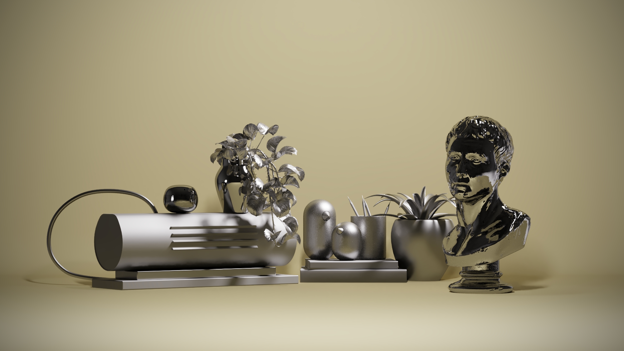

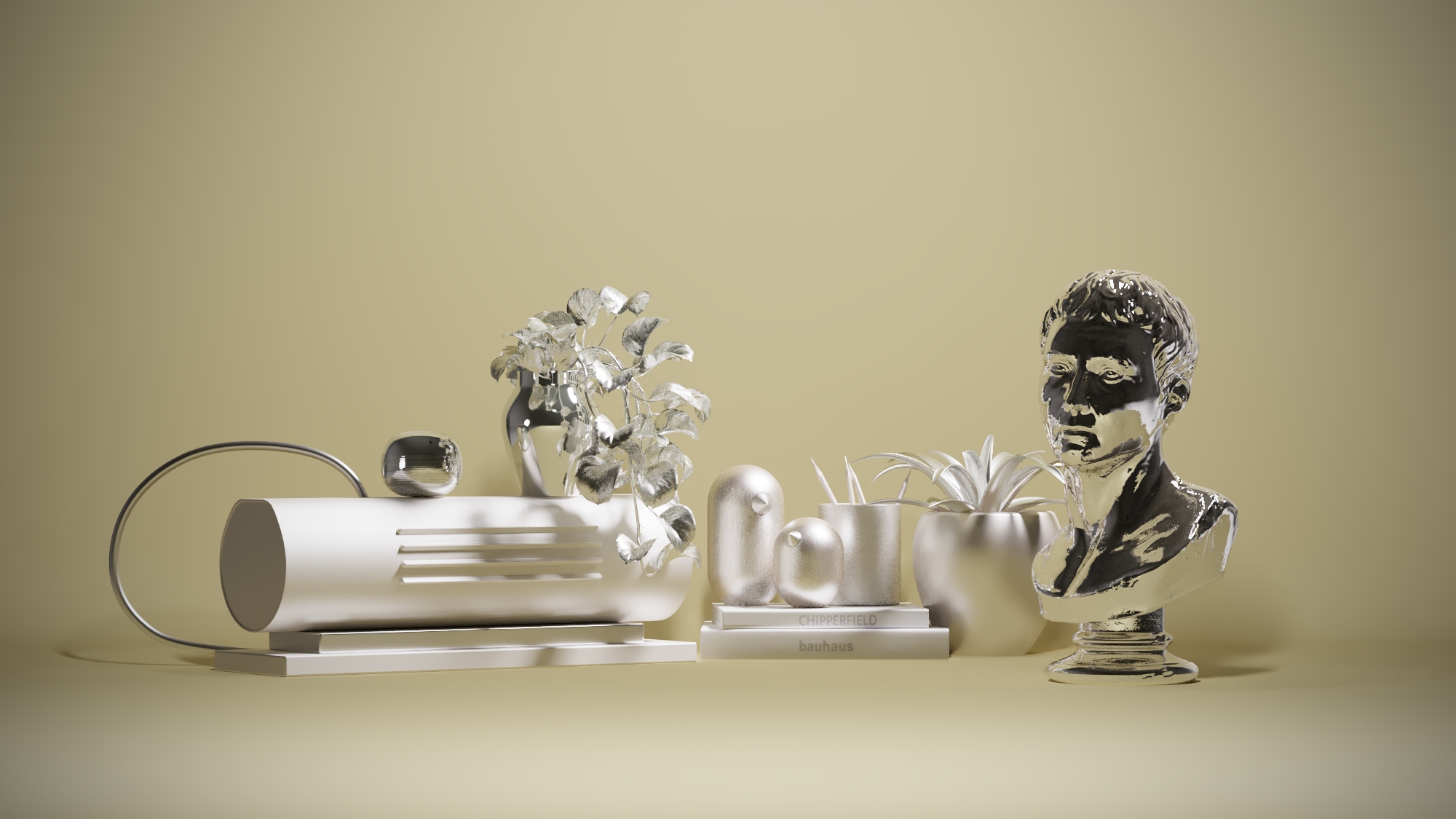

2. Fresnel IOR = 1.52 (default value)
With diffuse color:

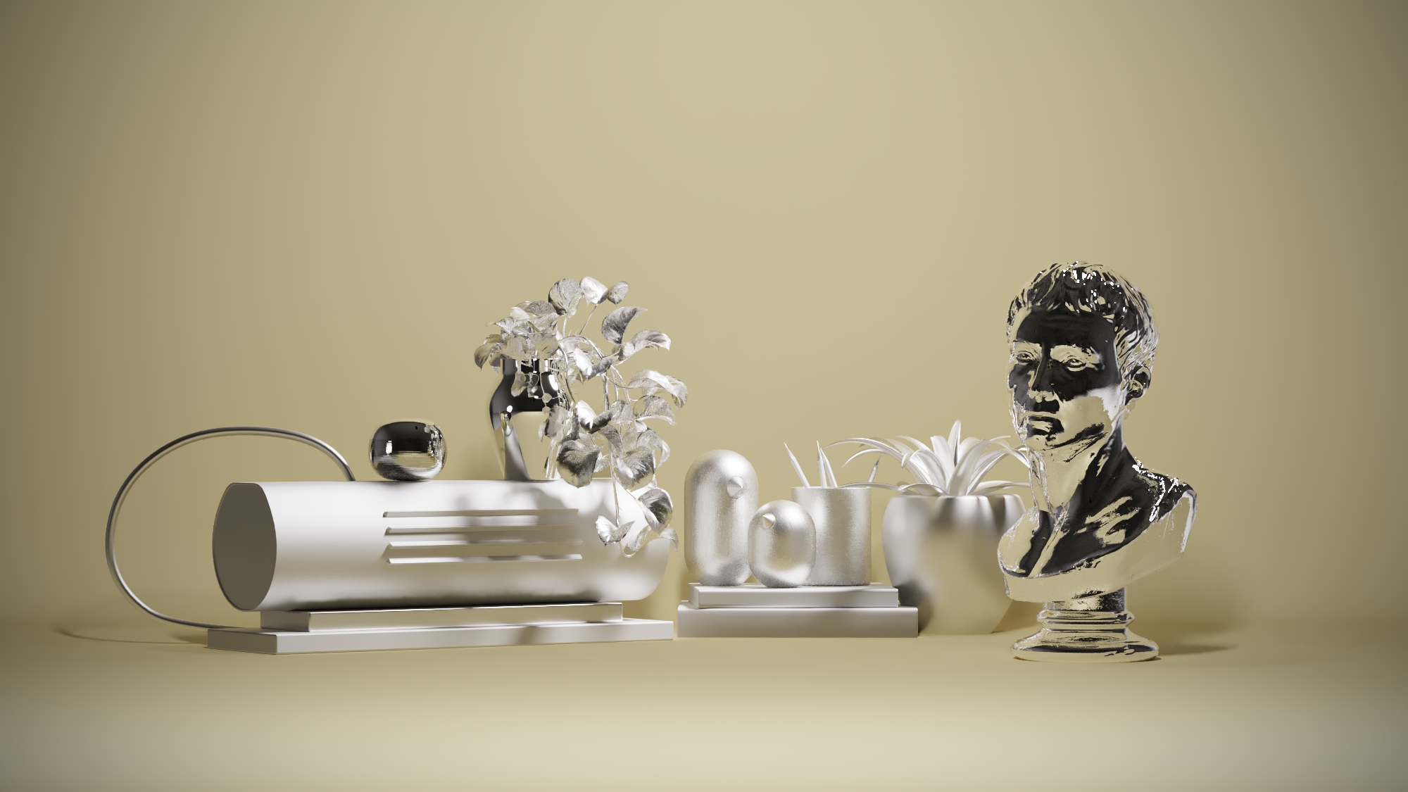

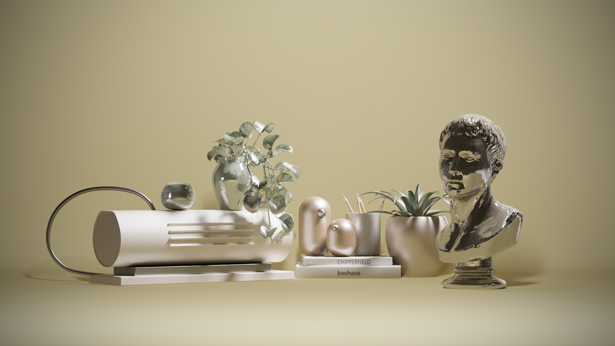

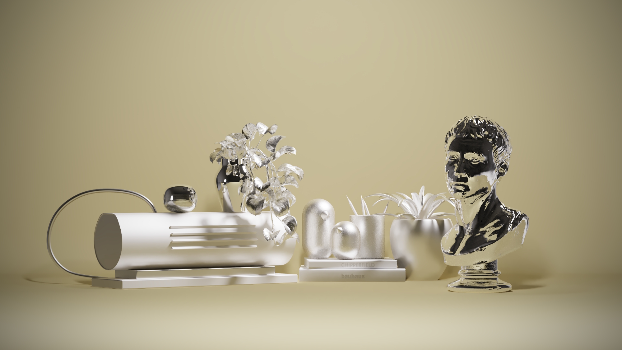

5. Fresnel IOR = 999 (virtually uniform reflection level)
With diffuse color:
