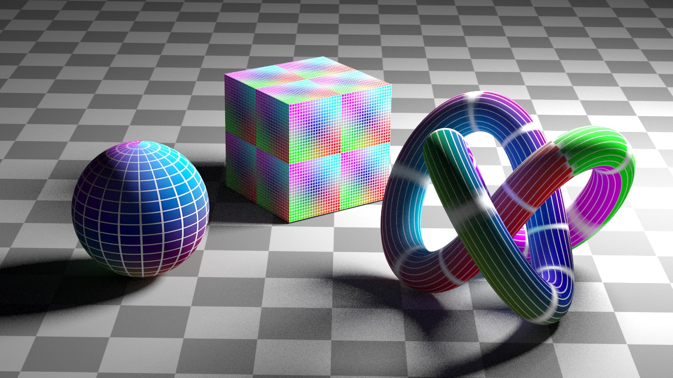

1. Bitmap texture - texture filtering on (All).
Note visible blurriness of the texture where it's stretched on the torus knot object.

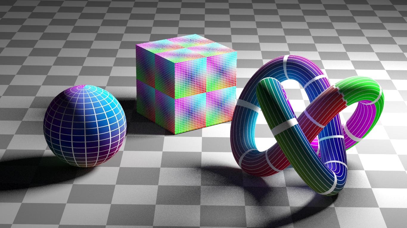

2. Bitmap texture - texture filtering off (None).
Note that blurriness on the torus knot object disappears.

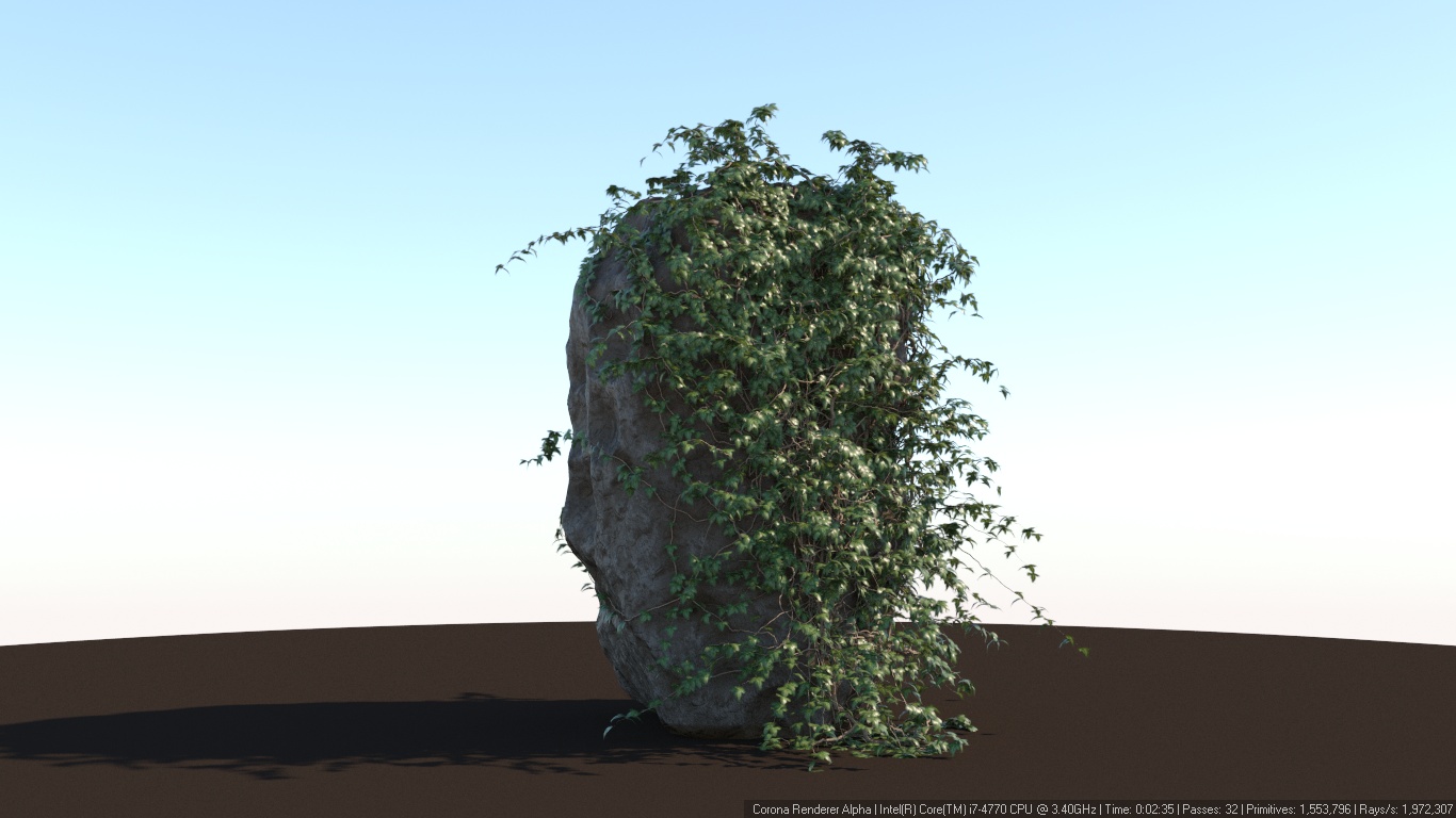

4. Bitmap as opacity map - texture filtering on (All).
32 passes
Rendering time: 02:35
Rays/s: 1,972,307
There is little visual difference, but rendering is significantly slower when texture filtering is enabled for opacity maps.
