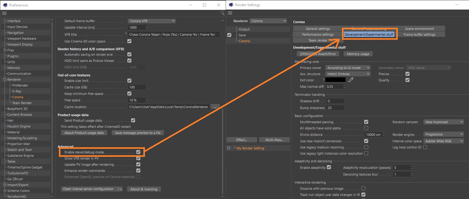

To enable the Development/Experimental stuff rollout:

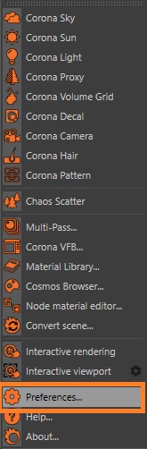

  1. Go to the menu Corona > Preferences.
  2. Under the "Advanced" category, check the "Enable devel/debug mode" checkbox.
  3. Close the window and then go to Render Settings
  4. A new "Development/Experimental stuff" tab will appear.
