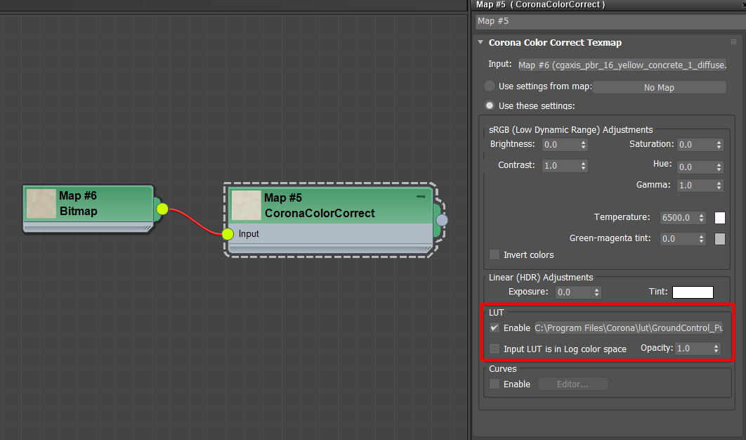

LUTs and Corona Output map
The CoronaColorCorrect map also supports LUT processing, which lets you apply LUTs to bitmaps, procedural maps, etc for use in your materials.
There is also an "Input LUT is in Log color space" checkbox, which should be enabled only in case the LUT effect is displayed incorrectly for the currently chosen file.
LUT processing can be enabled in the CoronaColorCorrect map
