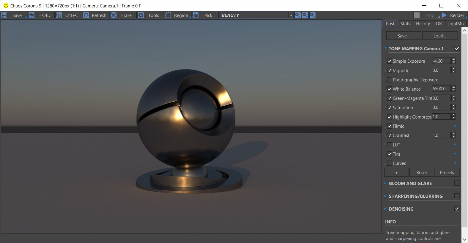

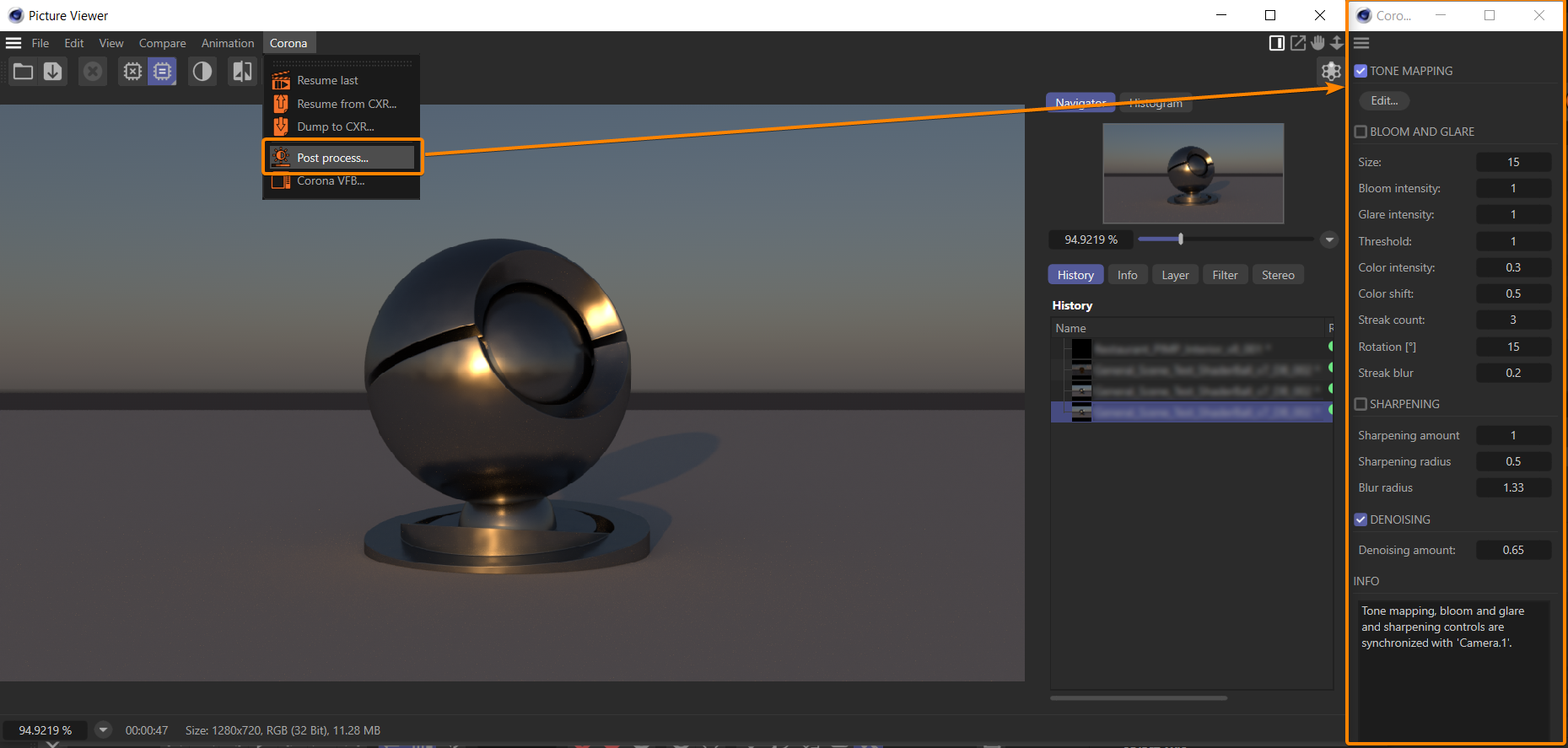

  • In C4D Picture Viewer > Corona > Post process... and Corona VFB > Post tab
    These settings are synchronized with the currently used exposure controls (render settings or camera tag). Updating them in one place will also affect the other places.
