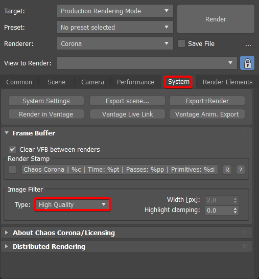

You can choose a specific image filter and adjust its width in Render Setup > System > Frame Buffer > Image Filter.
Enabling High-quality image filtering is equivalent to using a Tent filter with a width of 2. This option delivers noticeably higher image quality, even with fewer rendering passes. For the best balance between rendering speed and image quality, it’s generally recommended to keep the default image filter settings.
Note: Setting the image filter to “None” does not turn off antialiasing. Instead, it applies a box filter, which provides the lowest-quality antialiasing (a common default in many renderers). To completely disable antialiasing, refer to: How to disable antialiasing?
For optimal rendering performance and image quality, it’s best to leave the Corona image filtering settings at their default values.
