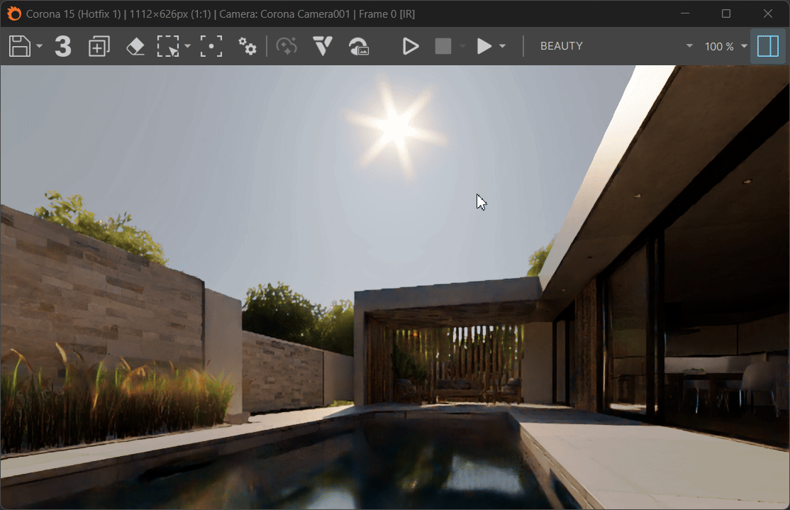

  • Corona uses physical sun and sky intensity, and the default camera exposure of 0 is intended for interior scenes. This means that after adding the sun and sky, your image may come out overexposed. To fix this, lower the Exposure (EV) value in the Corona VFB from the default 0 to about -2 to -4 or use automatic adjustments.

  • To specify the exact position of the sun or the moon in the sky, with the "Pick" button active, right click in the sky and select "Place sun/moon here"
