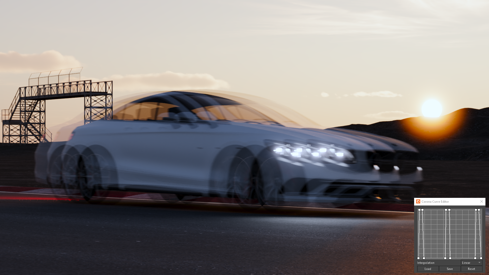

Shutter curve
Shutter curve allows you to fine tune the movement and look of how the motion blur results will appear in your rendered image. You can adjust the aspect of the motion blur by modifying the shutter curve. This simulates how fast or slow the shutter opens for each frame and enforces a good sense of motion on your subject. A more detailed explanation about this phenomenon - Camera Motion Blur Shutter Curve.
Various types of Shutter curve results can be seen in the examples below.

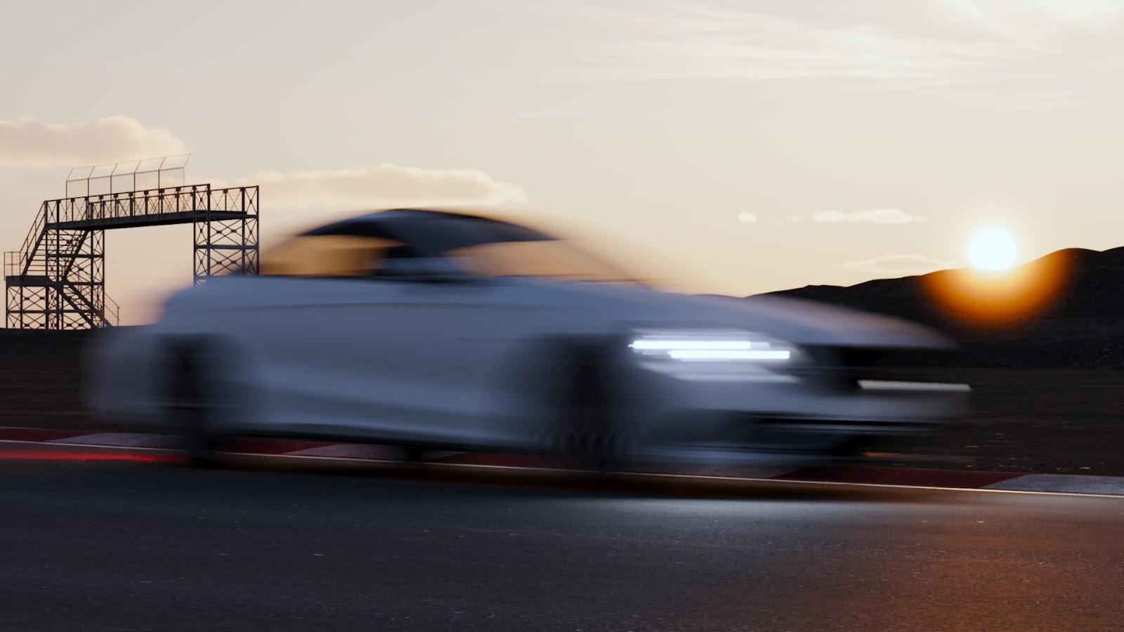

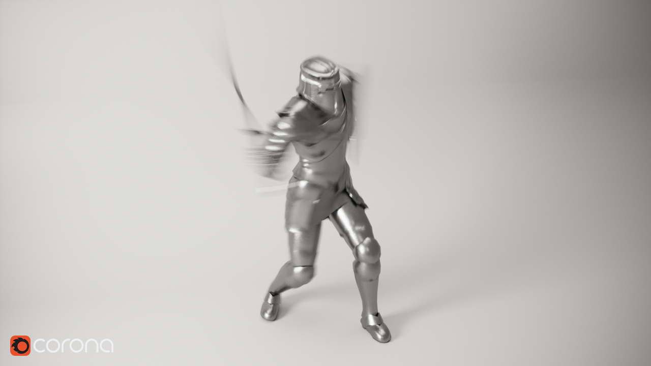

1. Motion blur - shutter speed 1/10s

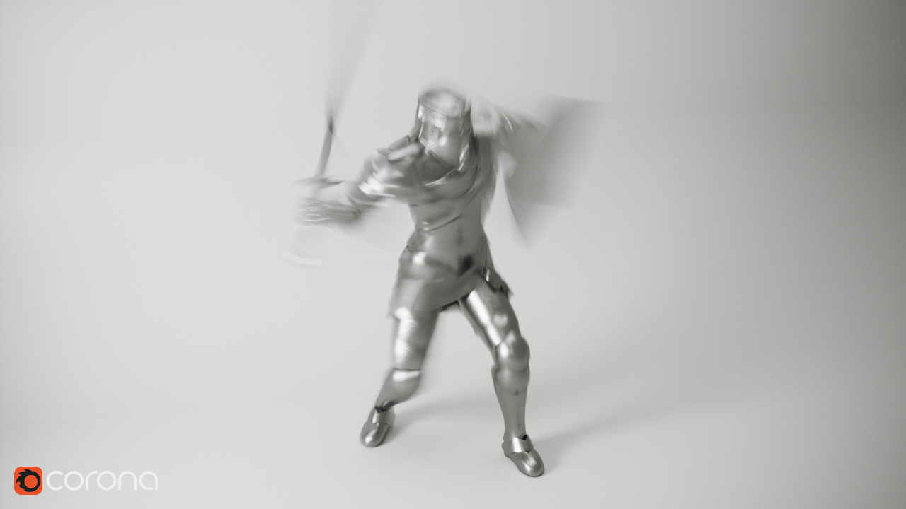

2. Motion blur - shutter speed 1/25s

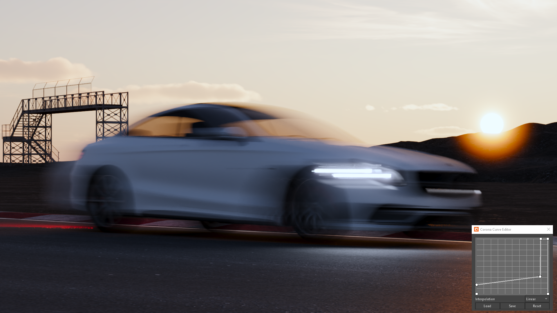

3. Motion blur - shutter speed 1/50s

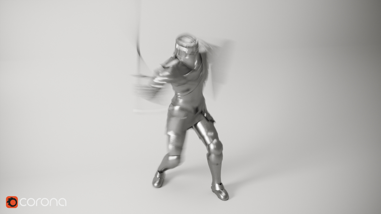

4. Motion blur - shutter speed 1/125s

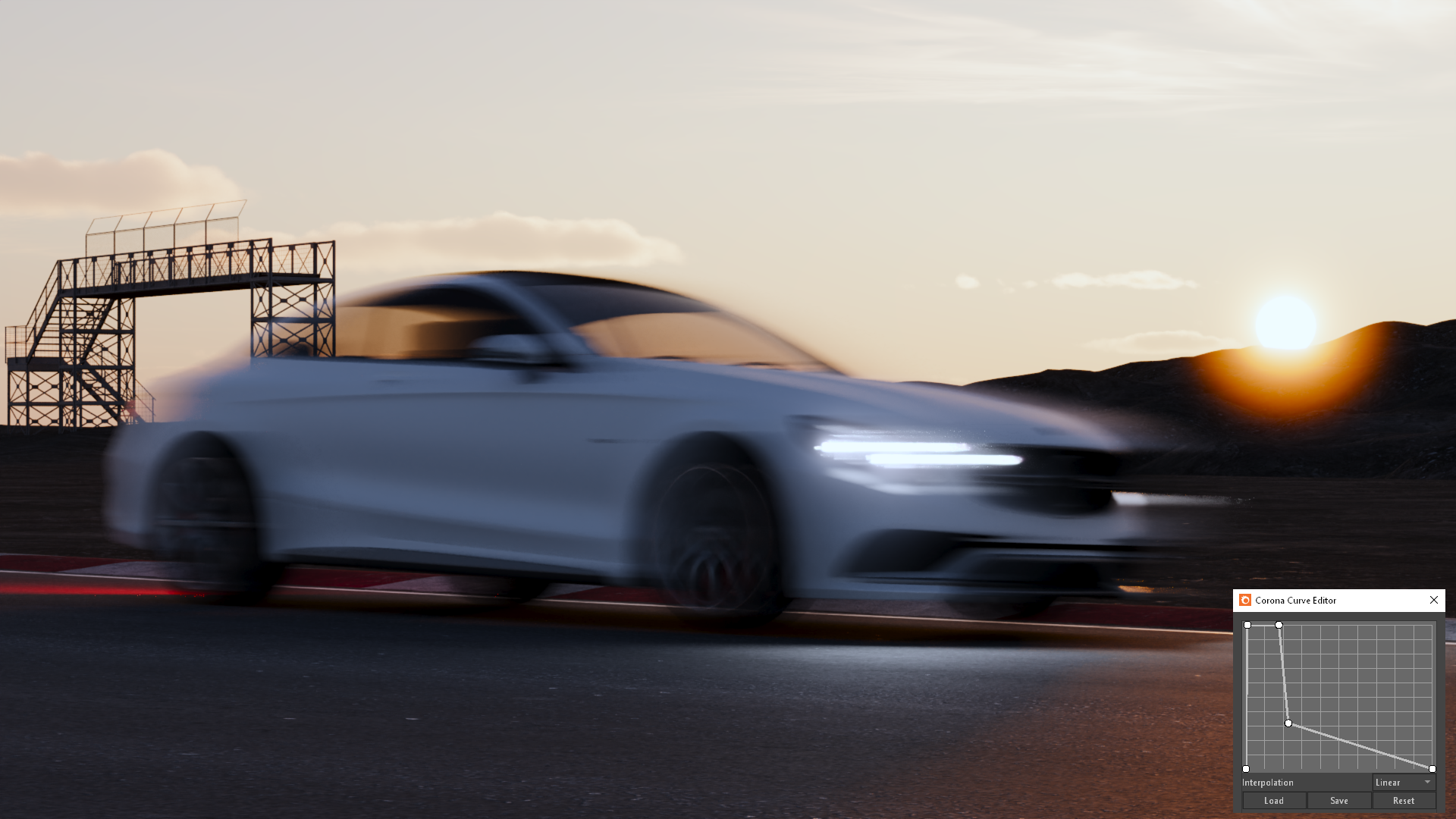

5. Shutter Curve
Default Shutter curve:
