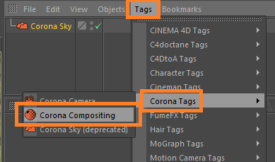

  • To make the environment visible only to specific ray types (direct visibility, GI, reflections, refraction), you can add Corona Compositing tag to the Corona Sky object (Tags > Corona Tags > Corona Compositing):

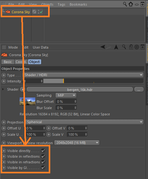

  • Alternatively, visibility options can also be found within the Corona Sky object itself:
