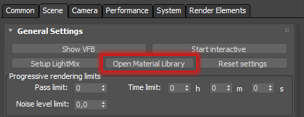

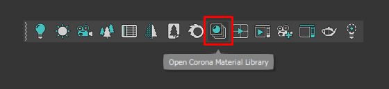

How to open it?
You can find the Material Library:
- In the Corona Renderer Official Toolbar:
- In the Scene tab of the Render Setup dialog:
