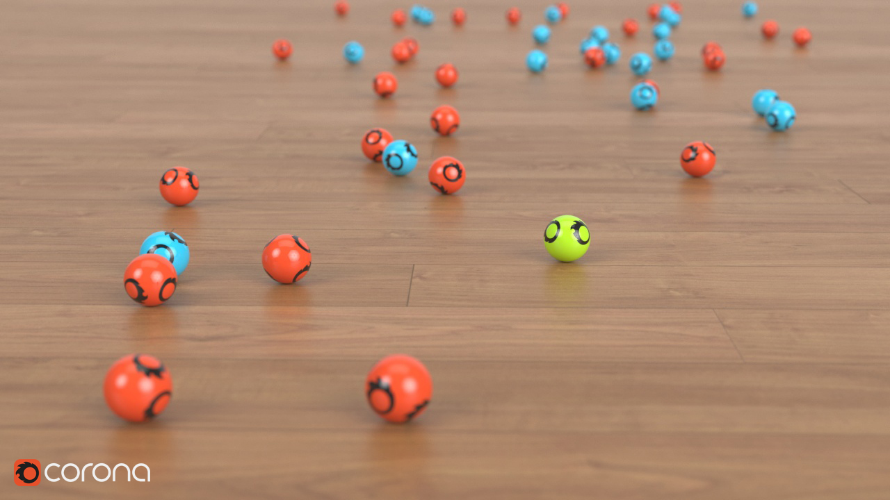

1. F-stop
As in photography, increasing the F-stop value will make the "dof" effect more subtle. Decreasing the F-stop value will make it more pronounced.
1.1 F-stop = 2 - pronounced DoF effect
1.2. F-stop = 4
1.3. F-stop = 16 - subtle DoF effect

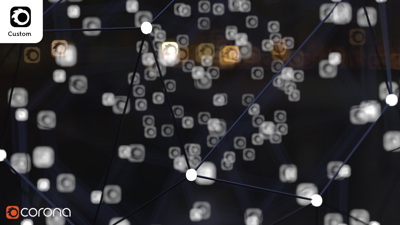

4.4. Custom 2:
4.4. Custom 3: "fake chromatic aberrations"

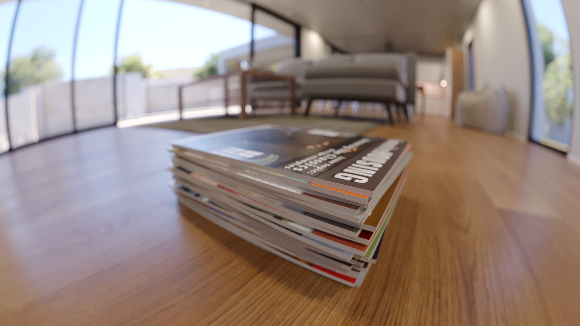

Starting with Corona 9, it is possible to Enable the Depth of Field in a Fisheye Camera. Simply create a Corona Camera, go to the attribute panel, open the Camera Projection, and set Type to "Fisheye":
Scene Setup:
Render:
