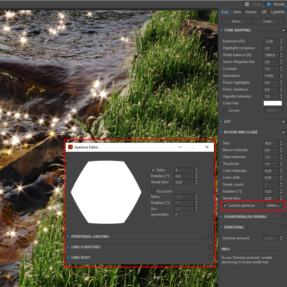

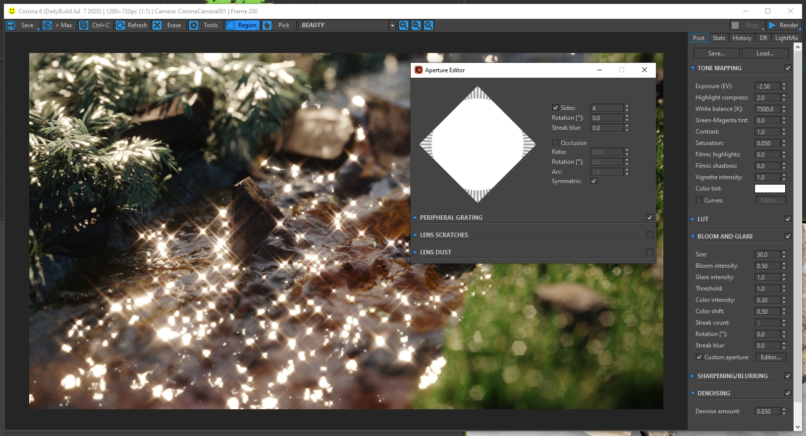

Custom aperture and the Aperture Editor
Starting with Corona Renderer 6, it is now possible to enable advanced Bloom and Glare effects through the Aperture Editor. Simply enable the "Custom aperture" checkbox and then click on the "Editor..." button. This will launch an editor which can be used to fine-tune advanced Bloom and Glare options:
Since there is a large number of settings in the Aperture Editor, usually some trial and error is required to get the desired effects. Below are examples of using various options:
"Sides" checkbox disabled - this results in the aperture being circle-shaped, rather than polygonal, and thus removes the streaks making the glare effect uniform and similar to the bloom effect:
Occlusion set to 0.2 - occlusion makes the aperture shape stretched vertically or horizontally, thus reducing some of the glare effect streaks:
Occlusion set to 0.92 - increasing the occlusion to high values will result in the glare effect being stretched in one direction:
Peripheral grating (default values) - enabling the peripheral grating option adds a halo effect to Bloom and Glare:
Peripheral grating length set to 1 - increasing the length value makes the colorful rainbow effect stronger:
Lens scratching - enabling this effect modifies the existing glare shape by either adding more streaks or stretching the effect in one direction:
Lens dust - this effect simulates dust particles on the lens surface:
Below are four examples of various Aperture Editor settings which help to produce different "looks" of the same image:
