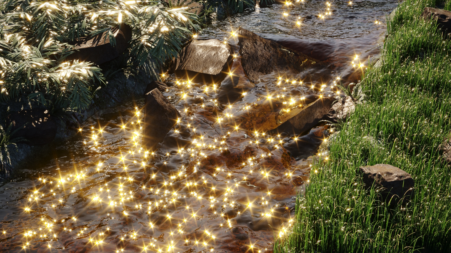

Glare
Glare creates a sharper, more focused glow with rays from bright areas in the image. This is ideal for creating a “starburst” effect around bright highlights on cars, from bright light sources, on gemstones, etc. The Hue Power and Shift parameters affect Glare in the same way as Bloom.
Bloom and glare disabled - click to enlarge
Glare enabled - click to enlarge
Bloom and Glare
Various examples of Bloom and glare used together:
