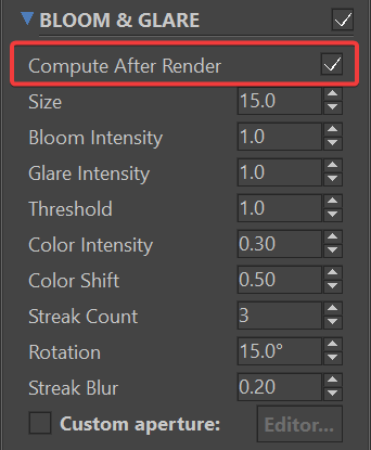

Compute after render – When enabled, this option tells Corona to apply the bloom and glare effects only after the rendering is complete, rather than calculating it during the rendering process. This allows Corona to focus all available computing power on rendering the image itself, which can help speed up the render. If this option is disabled, the bloom and glare effect is calculated live as the image is being rendered, which may slightly slow down the process.

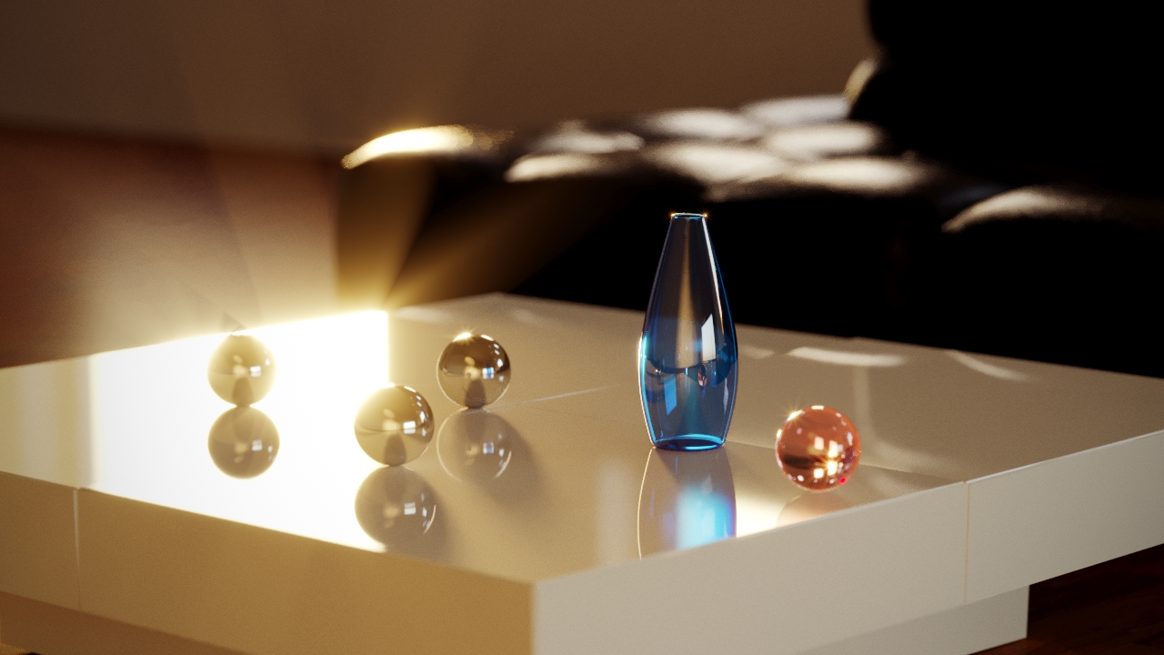

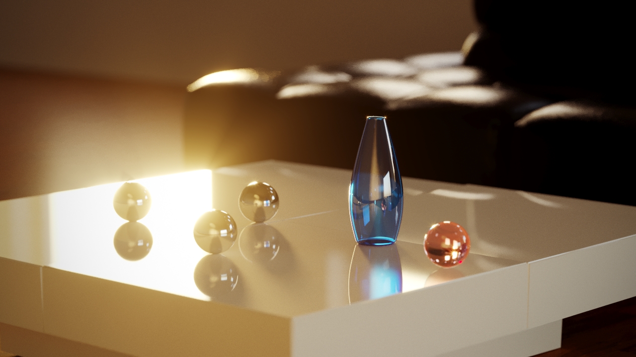

Bloom
Bloom creates a large, soft glow around bright areas in the image, ideal for adding softness to windows as an example or giving a soft glow around a candle flame. Hue Power and Shift let you adjust the hue of the effect rather than have it purely depend on the color of the light source.
Bloom and glare disabled - click to enlarge
Bloom enabled - click to enlarge

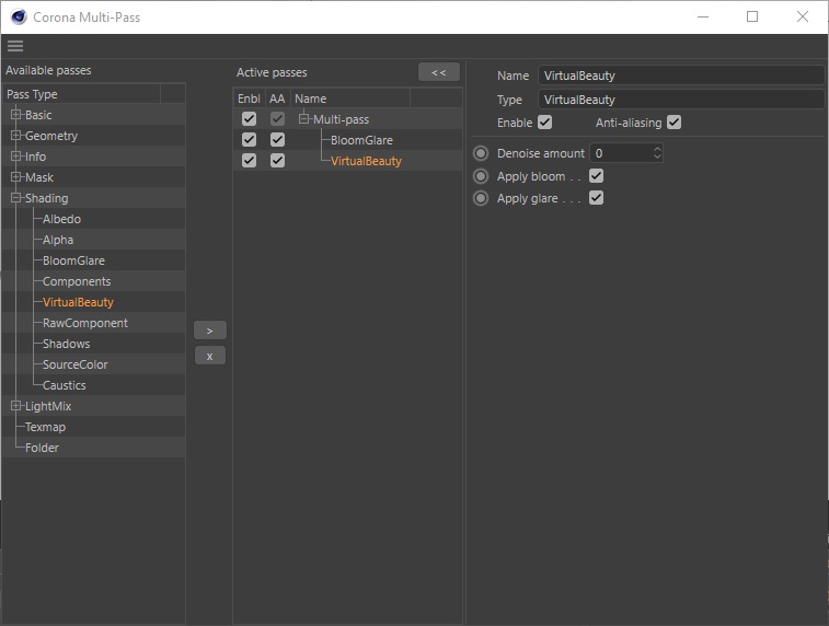

Other Pass Types
VirtualBeauty and LightMix pass types can be created and saved with or without Bloom and Glare effects applied. It is also possible to toggle Bloom only or glare only using the checkboxes in the VirtualBeauty, LightMix, and BloomGlare multi-pass settings:

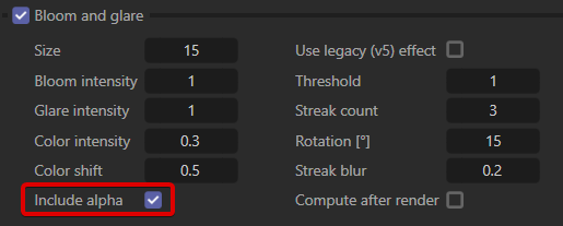

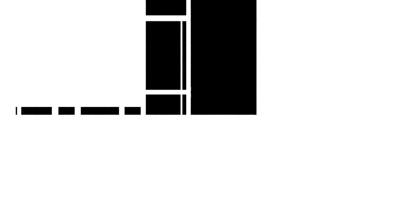

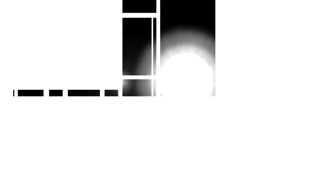

Starting with Corona 12 Update 2 it is possible to decide whether the Bloom and Glare effect should be included in the image alpha channel or not. You can find the setting in Render Settings > Camera/Postprocessing > Bloom and glare.

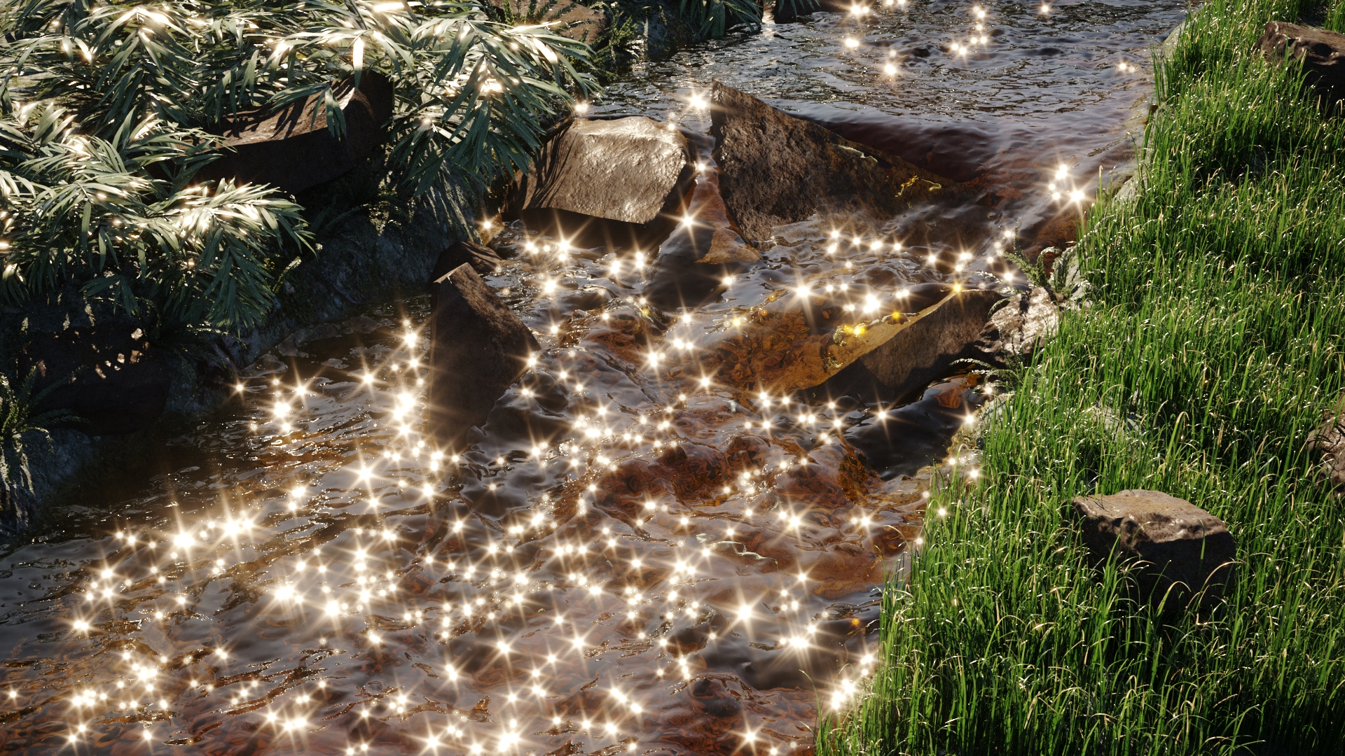

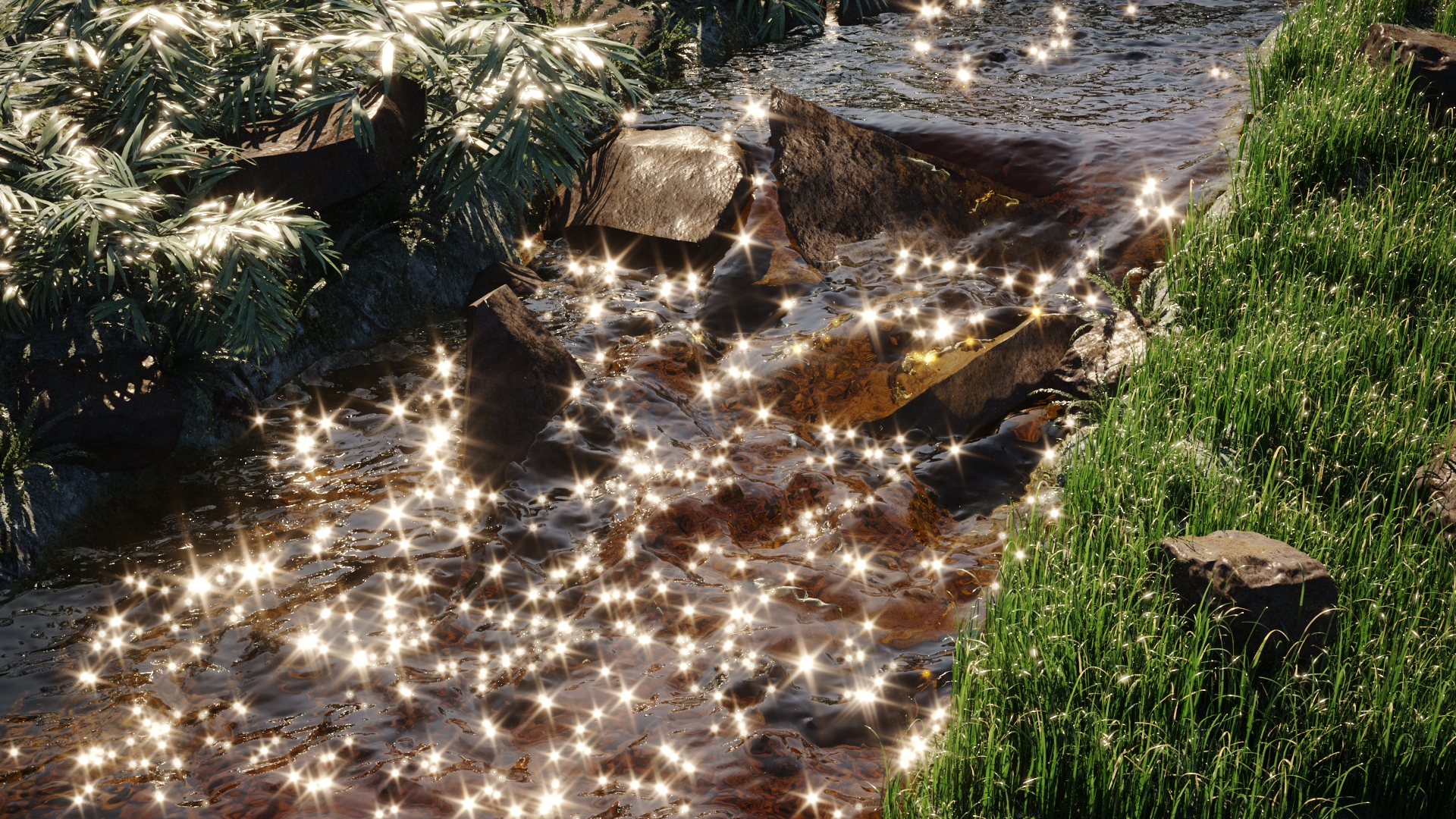

An image rendered with the bloom and glare effect enabled:
The alpha channel of the above image with the Include Alpha option disabled:
The alpha channel of the above image with the Include Alpha option enabled:

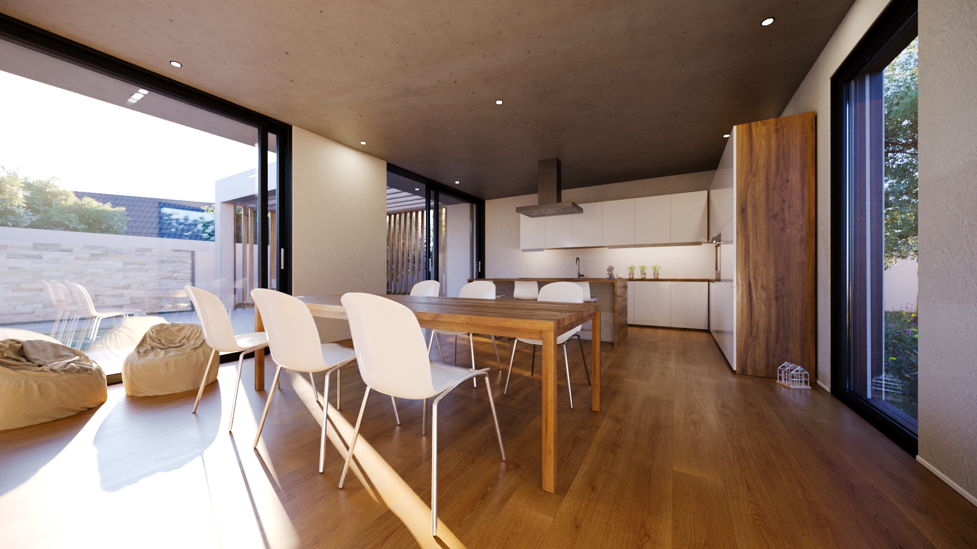

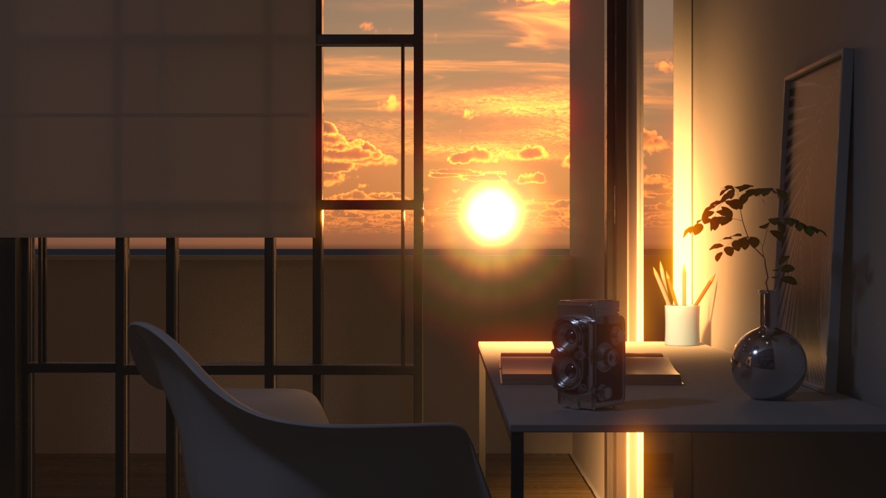

Bloom and Glare and Realism

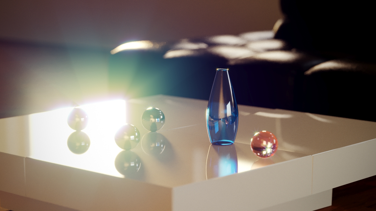

Bloom and glare are effects that happen in real life due to the imperfections of camera lenses and sensors, so they often appear in real-life photos. Remember that enabling them will usually increase the realism of your renders. On the other hand, the effect should not be exaggerated, and Bloom and Glare should remain subtle.
Image with Bloom and Glare disabled:
The same image with Bloom and Glare enabled:
Note how the scene realism is boosted, not only by adding the strong glare around the sun but also thanks to the subtle glow around the ceiling lamps.

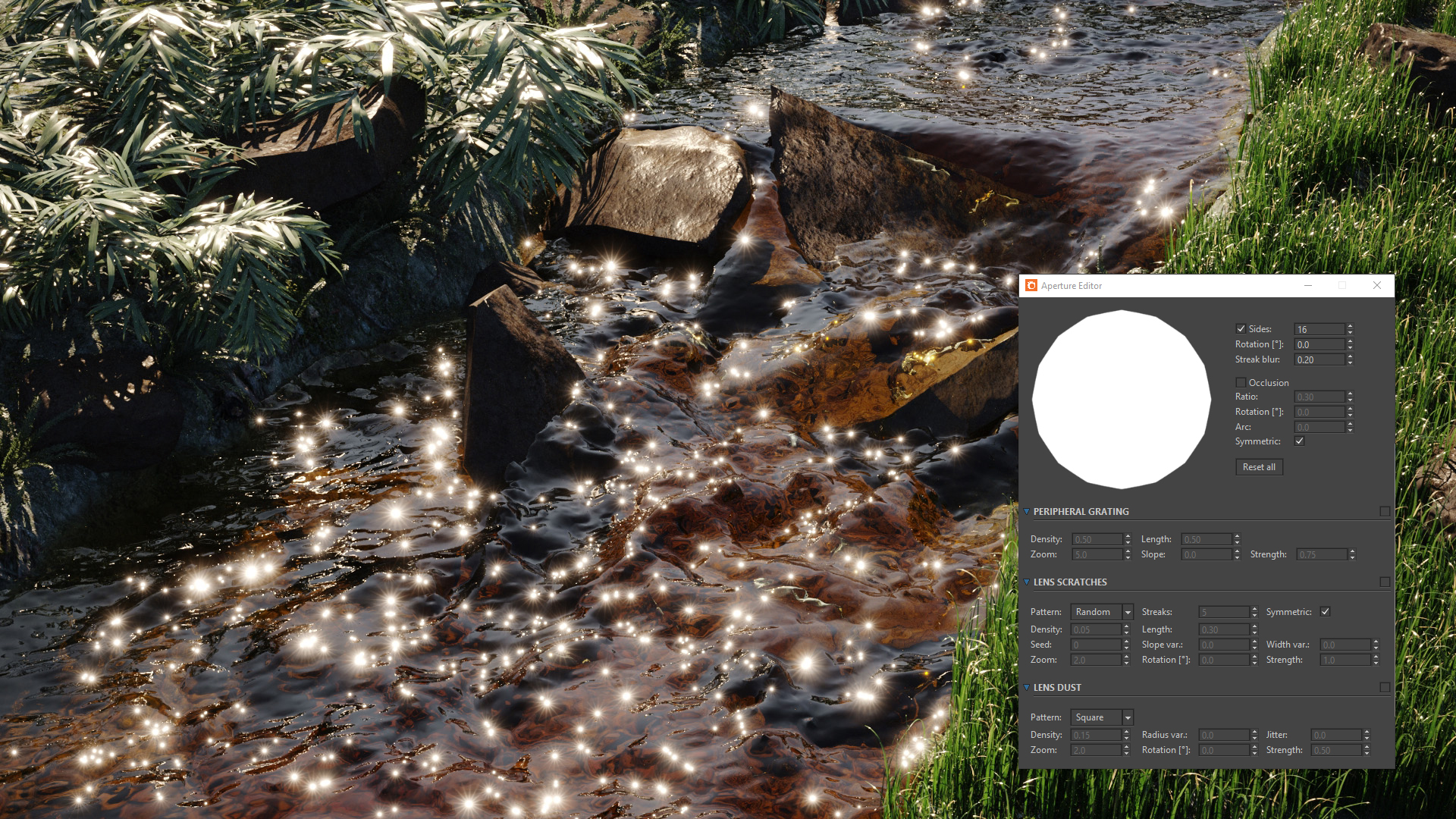

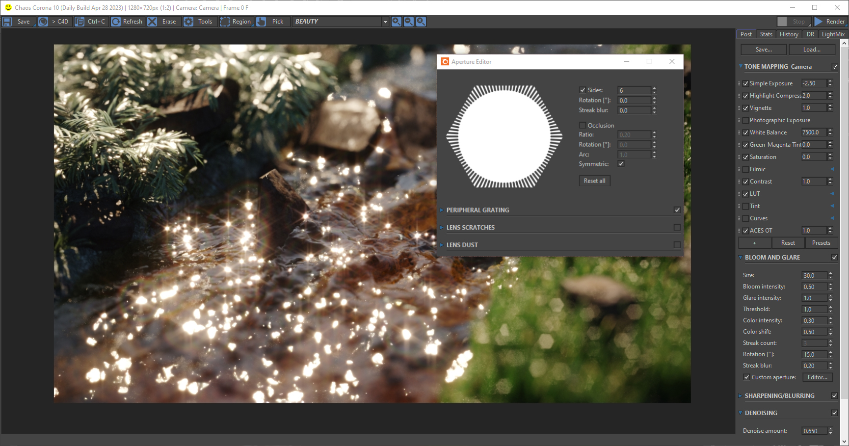

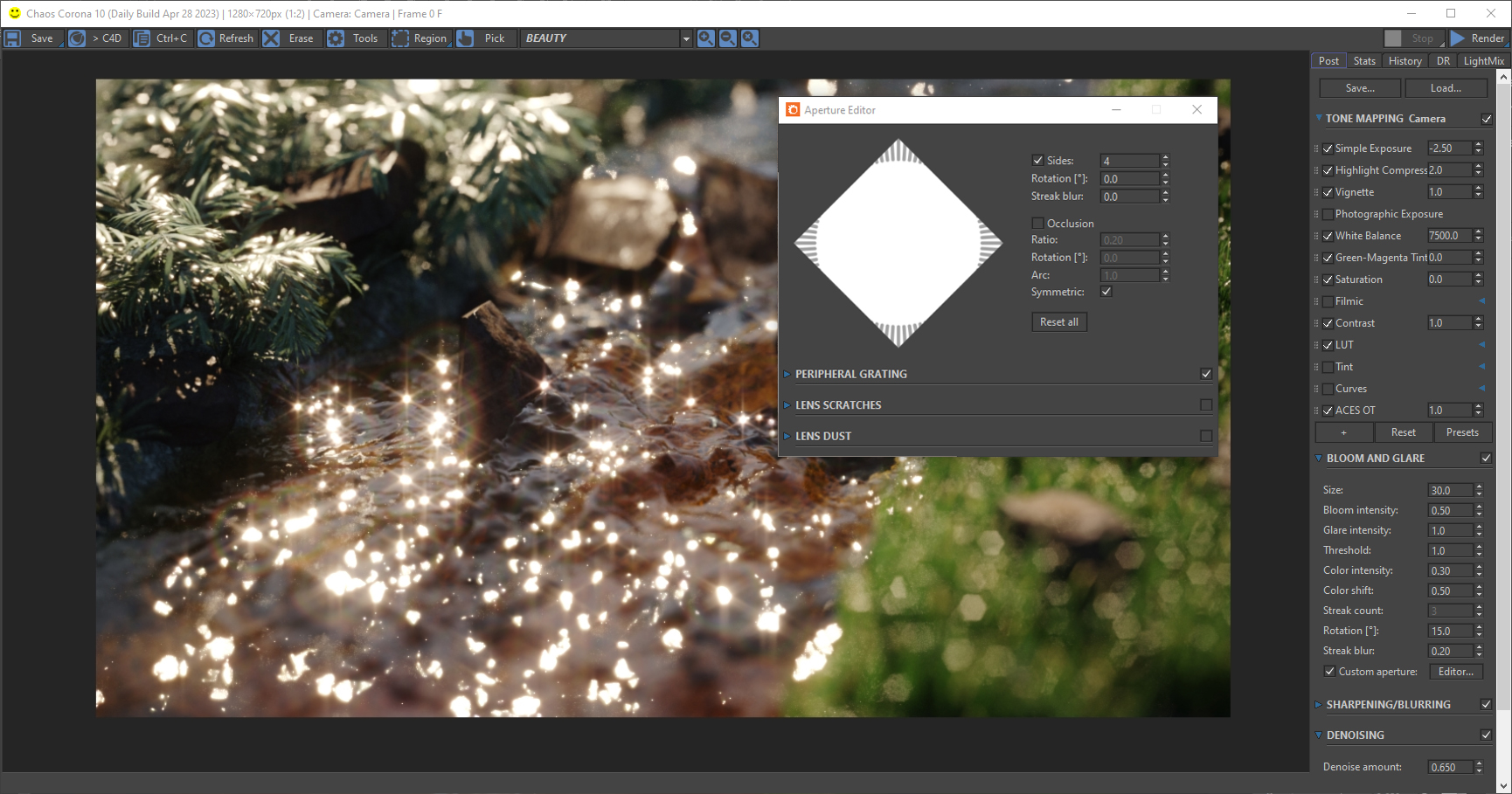

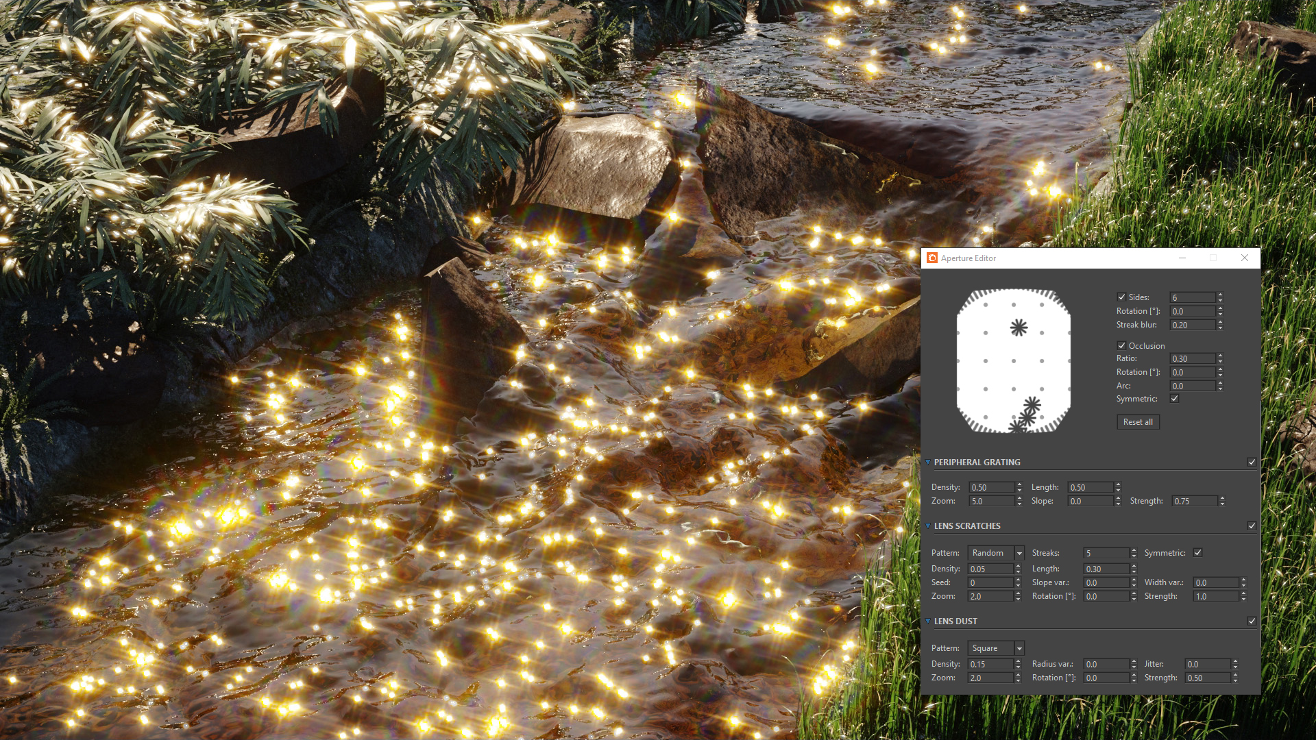

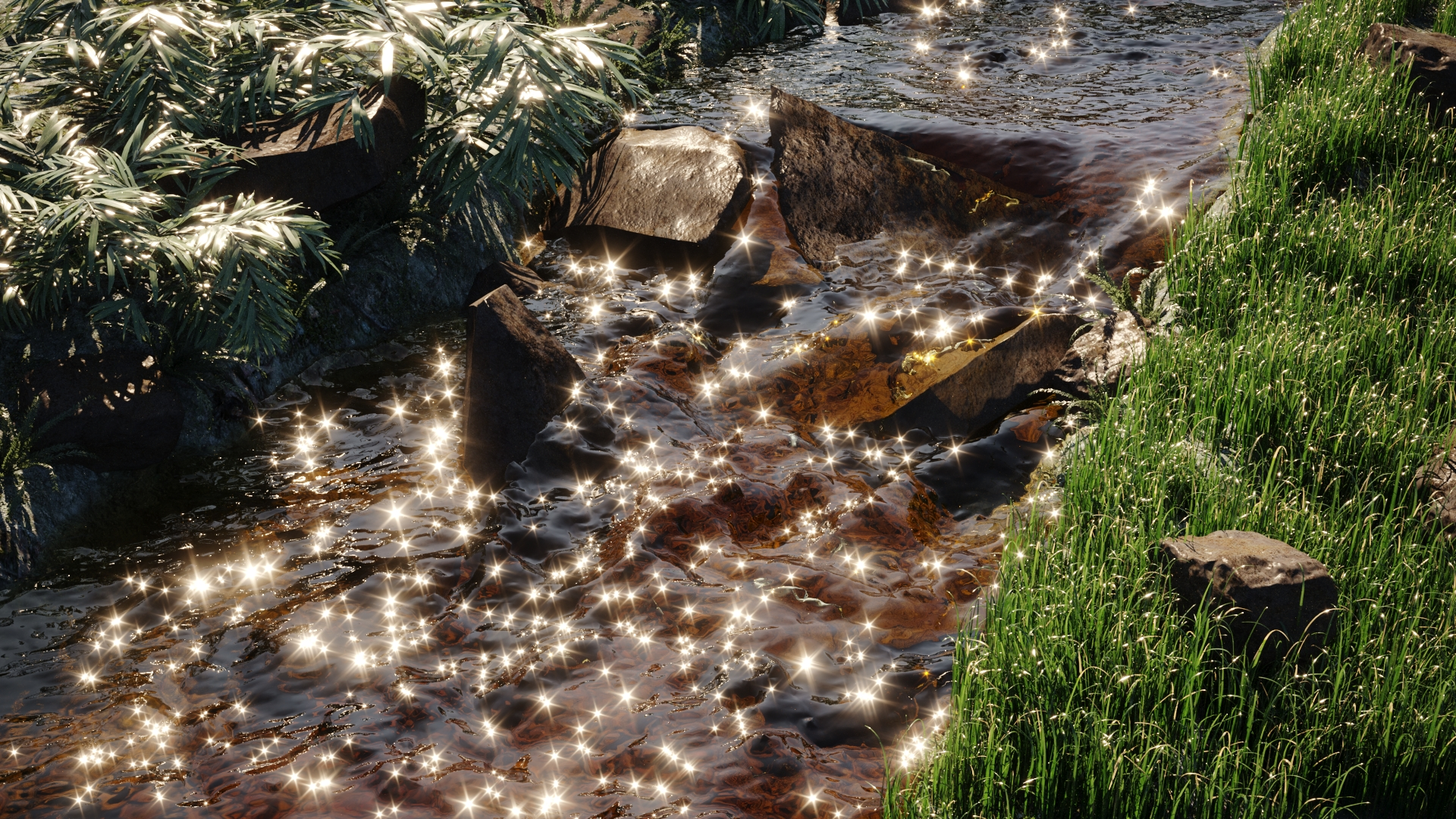

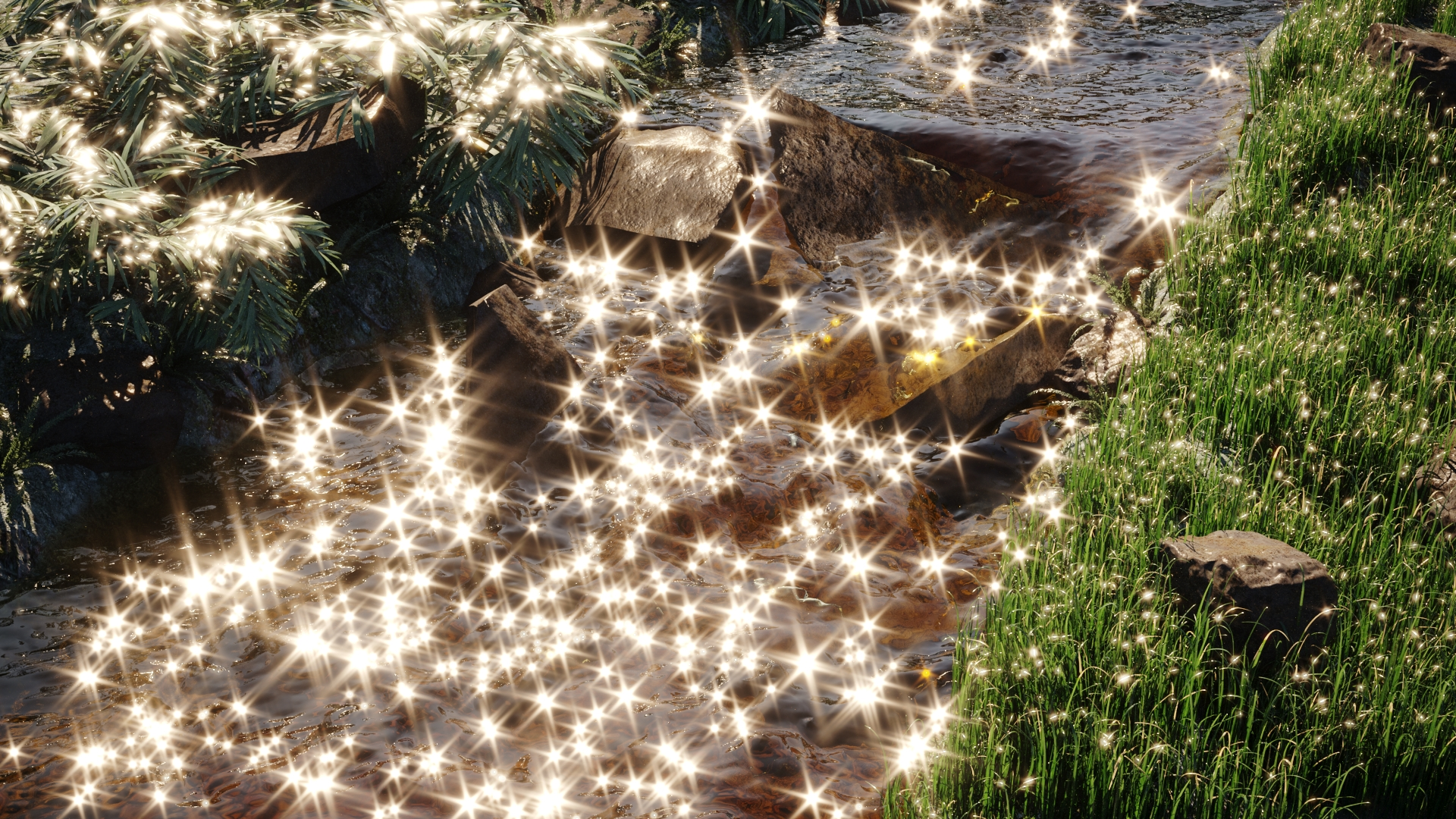

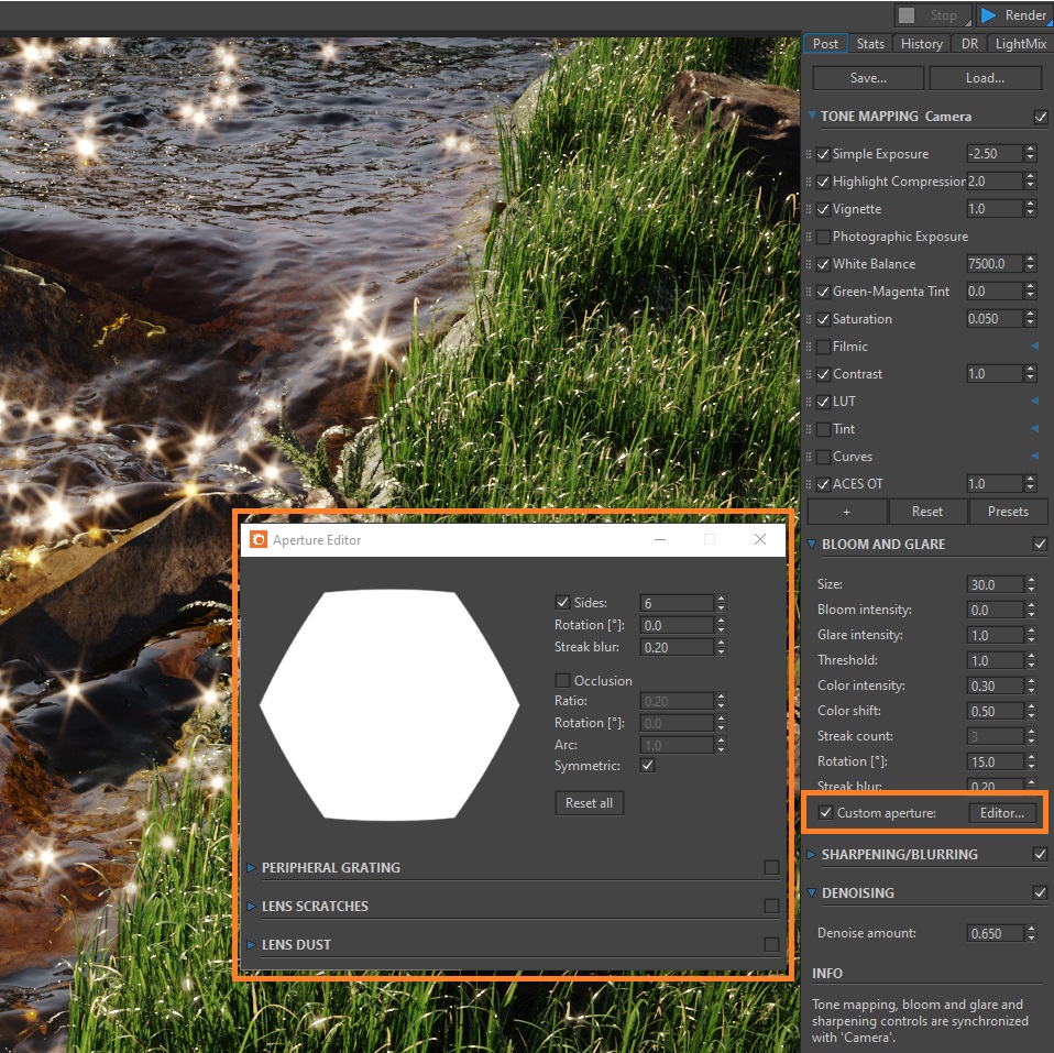

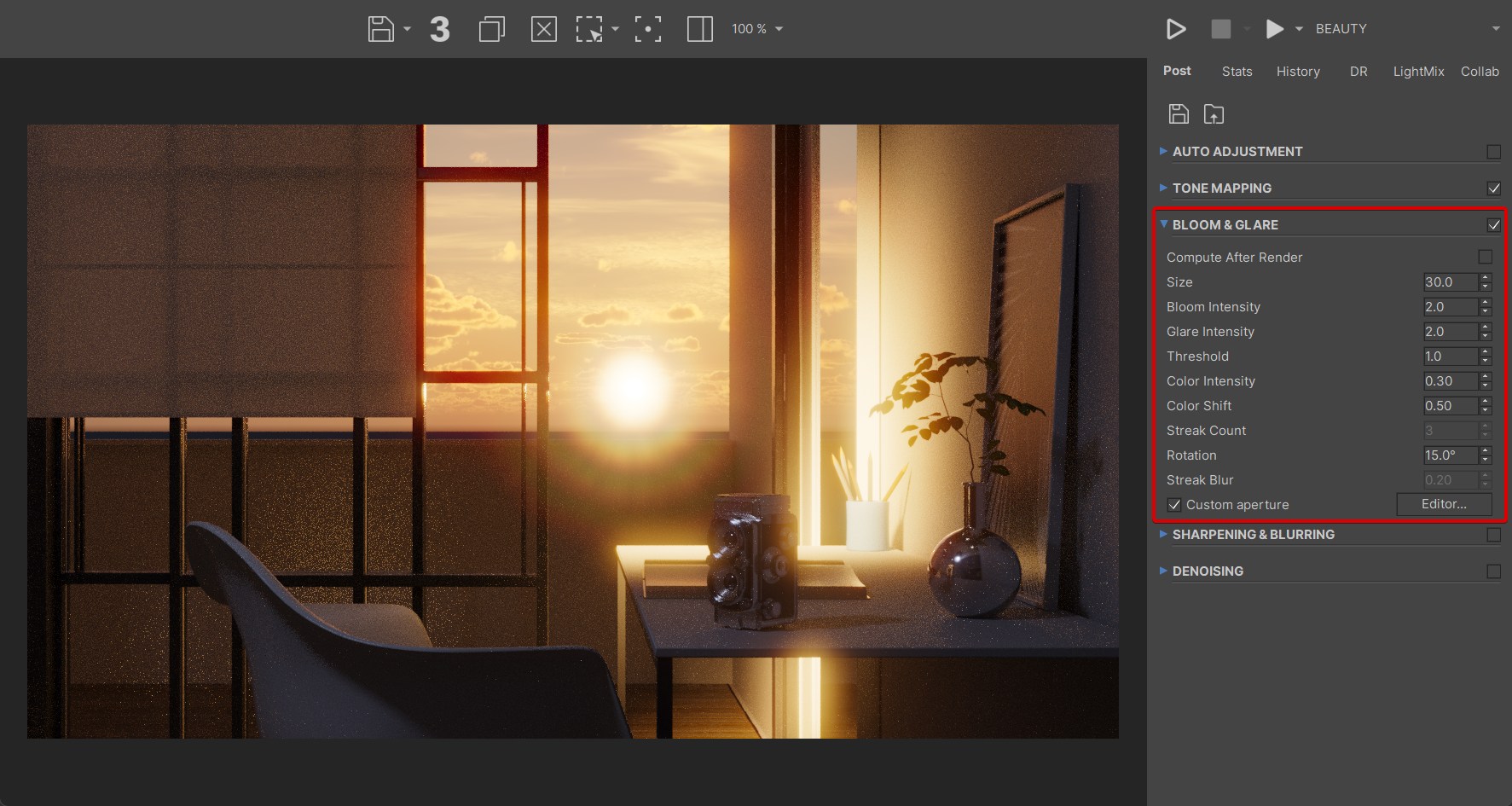

Custom aperture and the Aperture Editor
Advanced Bloom and Glare effects can be achieved using the Aperture Editor. Simply enable the "Custom aperture" checkbox and then click on the "Editor..." button. This will launch an editor which can be used to fine-tune advanced Bloom and Glare options:
Since there is a large number of settings in the Aperture Editor, usually some trial and error is required to get the desired effects. Below are examples of using various options:
"Sides" checkbox disabled - this results in the aperture being circle-shaped, rather than polygonal, and thus removes the streaks making the glare effect uniform and similar to the bloom effect:

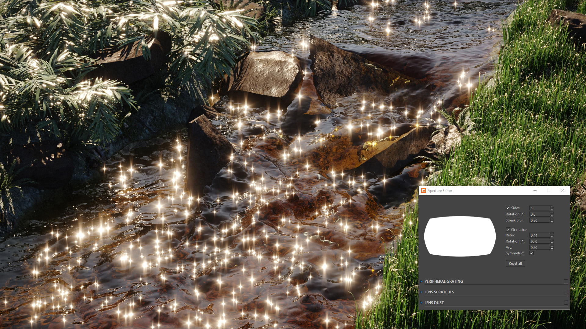

Occlusion set to 0.2 - occlusion makes the aperture shape stretched vertically or horizontally, thus reducing some of the glare effect streaks:
Occlusion set to 0.92 - increasing the occlusion to high values will result in the glare effect being stretched in one direction:

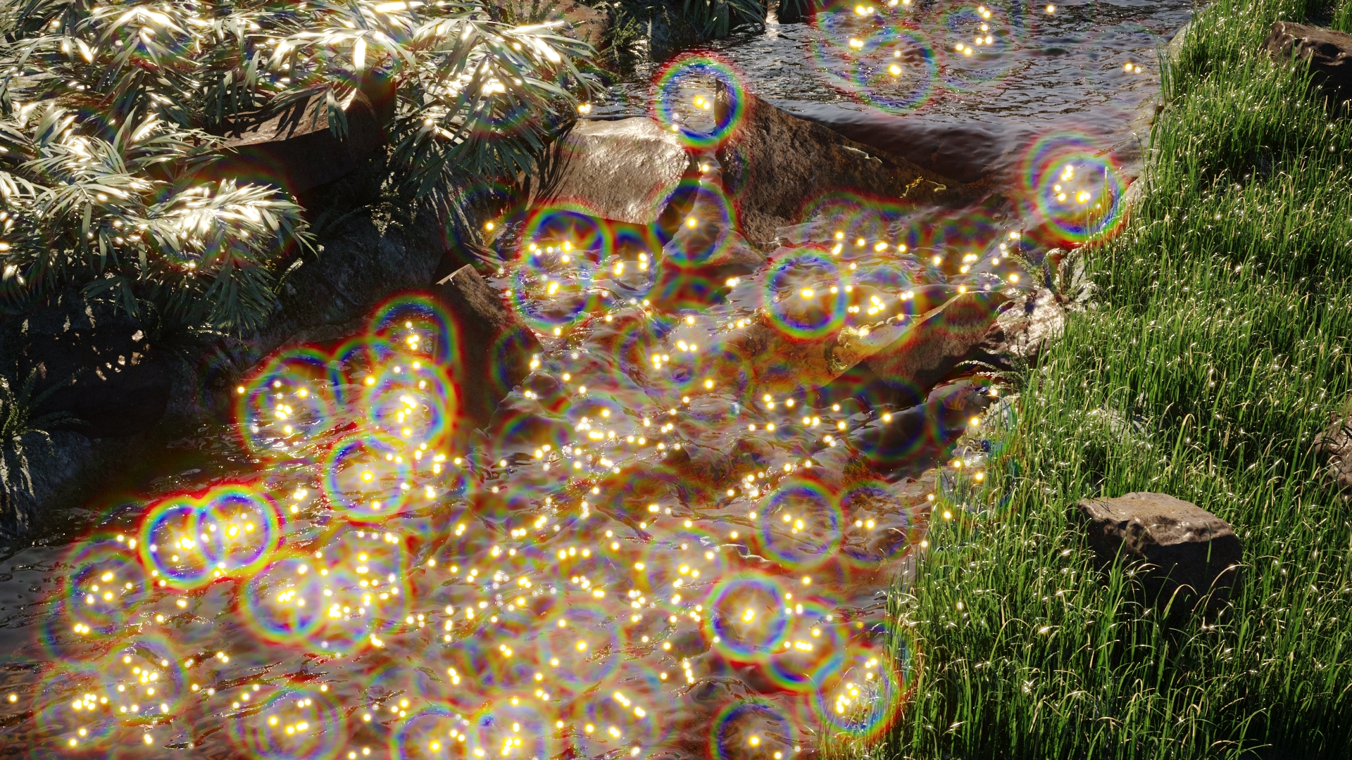

Peripheral grating (default values) - enabling the peripheral grating option adds a halo effect to Bloom and Glare:
Peripheral grating length set to 1 - increasing the length value makes the colorful rainbow effect stronger:

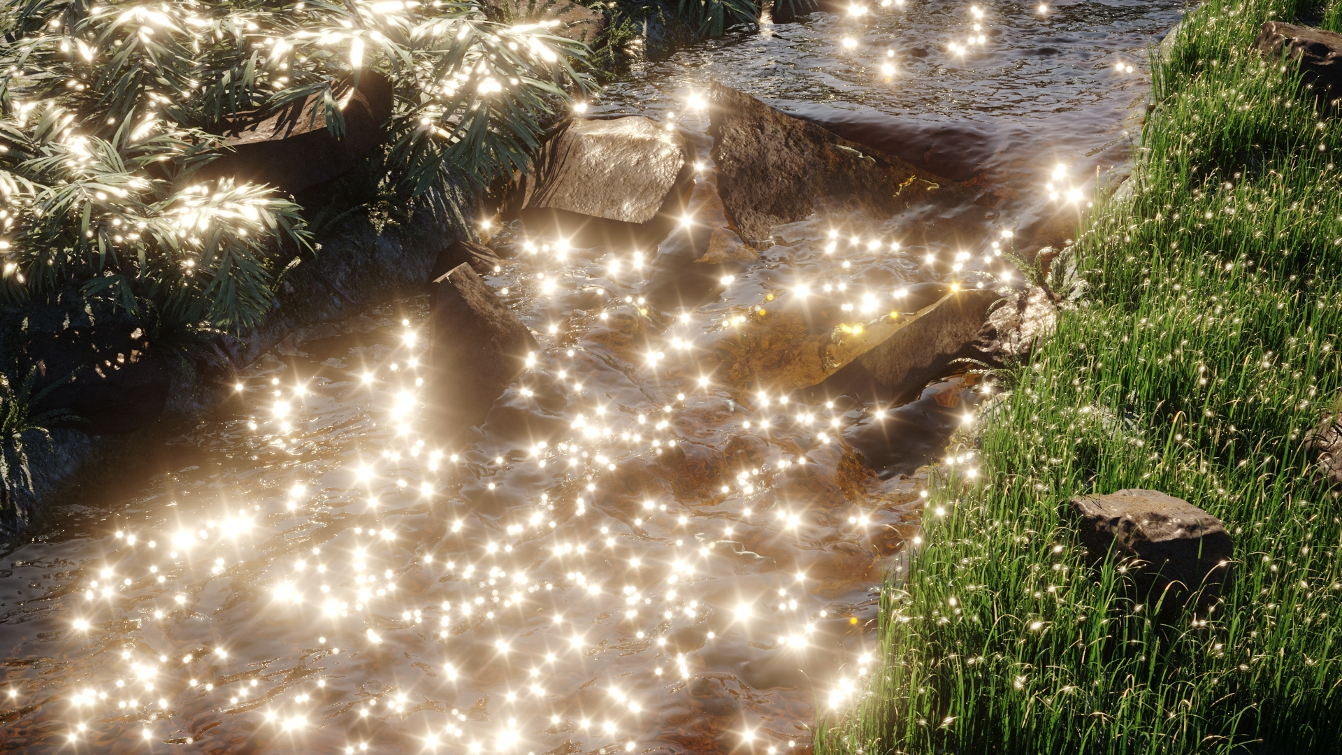

Lens dust - this effect simulates dust particles on the lens surface:
Below are four examples of various Aperture Editor settings which help to produce different "looks" of the same image:
