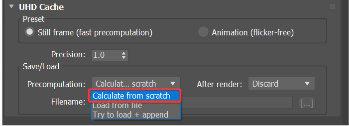

1. Calculate from scratch - when using this mode, the cache will be always calculated independently for each frame, and either discarded after the rendering stops, or saved, depending on the "After render" setting. The single saved cache file can then be re-used.
Note: when using the "Calculate from scratch" mode, only one file will be saved, containing information about the lighting calculated based on a single frame. In this mode, you cannot collect lighting information from multiple frames of the animation and merge them. Considering that, it makes sense to calculate this file only once and it does not make sense to calculate it for multiple frames. In case of using "Calculate from scratch" mode and rendering multiple frames, the cache file will be calculated from scratch and overwritten every time a new frame is rendered.
Typical use cases:
  • Rendering a single, static image:
    • Calculate from scratch + Discard
  • Rendering a fly-through animation with no moving objects or lights:
    • Calculate from scratch + Save to file (render one frame of the animation only and reuse the resulting cache file for all other frames)
    • Then switch to "Load from file" (see below) and render the whole animation

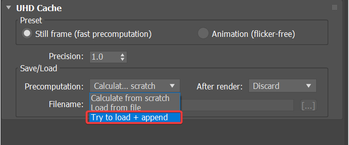

3. Try to load + append - this will first load a previously saved cache file specified in the "Filename" field and then the precomputation pass will run on top of it. The loaded and computed caches will be merged. If the file to load is not found - the precomputation will begin anyway.
Note: this mode stores information about multiple frames inside a single cache file. It does not generate multiple cache files.
Typical use case:
  • Rendering a fly-through animation with objects or lights which are moving just a little bit (e.g. a curtain on the wind)
    • Use the Try to load + append option and render every n-th frame (for example every 30th frame of the animation). Then switch to Load from file mode and render the whole sequence. The cache file will contain information from multiple frames (because the Try to load + append mode was used to generate it) and Corona will smartly use the available data for all animation frames. This can save time when rendering long animations since the cache does not have to be calculated from scratch for every frame.

1. Camera fly-through, without any moving lights or objects:
Always use the "Animation (flicker-free)" preset. If you want to save the time required for precomputation of each frame, you can render the UHD Cache for one frame from the middle of the animation and then re-use it for all the other frames. You can also use combination of "Try to Load + Append" and "Save to file" options to render the cache incrementally. This should be done for several frames of the animation. For example for 400-frames animation, you can set 3ds Max to render every 50th frame to render the UHD Cache only for 8 frames.
Step-by-step:
  • Rendering a fly-through without any moving lights or objects:
    • Go to the middle of your animation (e.g. frame 50 in case of a 100-frame sequence)
    • Enable "Animation (flicker-free)" preset
    • Set Precomputation to "Calculate from scratch" and After render to "Save to file"
    • Specify the path to save your cache file
    • Set your rendering to 1 second only (see: How to set limit for rendering?)
    • Set your rendering to render only 1 frame (not a sequence)
    • Render - this will render your image for only 1 second so almost no actual rendering will be done, but the cache file will be calculated and saved
    • Set Precomputation to "Load from file"
    • Set your desired render limit (for example 5 minutes per frame, 100 passes, or 2% noise limit)
    • Set your rendering to full sequence
    • Render
    • Your full sequence will be rendered using the cache file generated from a single frame. The same cache will be used for every frame of the animation.

  • Rendering an animation where the lights or objects are moving just a little bit, or slowly:
    • Set Precomputation to "Try to load + append" and After render to "Save to file"
    • Go to the first frame of your animation (e.g. frame 0)
    • Set your host application to render every n-th frame
      • for example, in case of a 400-frames animation, you can set it to render every 50th frame to render the UHD Cache only for 8 frames
      • the specific n-th frame number depends on the length of the animation and the pace at which the objects are moving - this requires a trial and error approach
      • the more frames are rendered, the better the quality of the cache will be
    • Render - this will render n-th frame for only 1 second so almost no actual rendering will be done, but each time new data will be calculated and added to the existing cache
    • Once the process of calculating the cache for all frames is done, set Precomputation to "Load from file"
    • Set your rendering to full sequence and disable the option to render every n-th frame (be sure to render all frames)
    • Render
    • Your full sequence will be rendered using the cache file generated from multiple frames. Corona will smartly use all available data.
