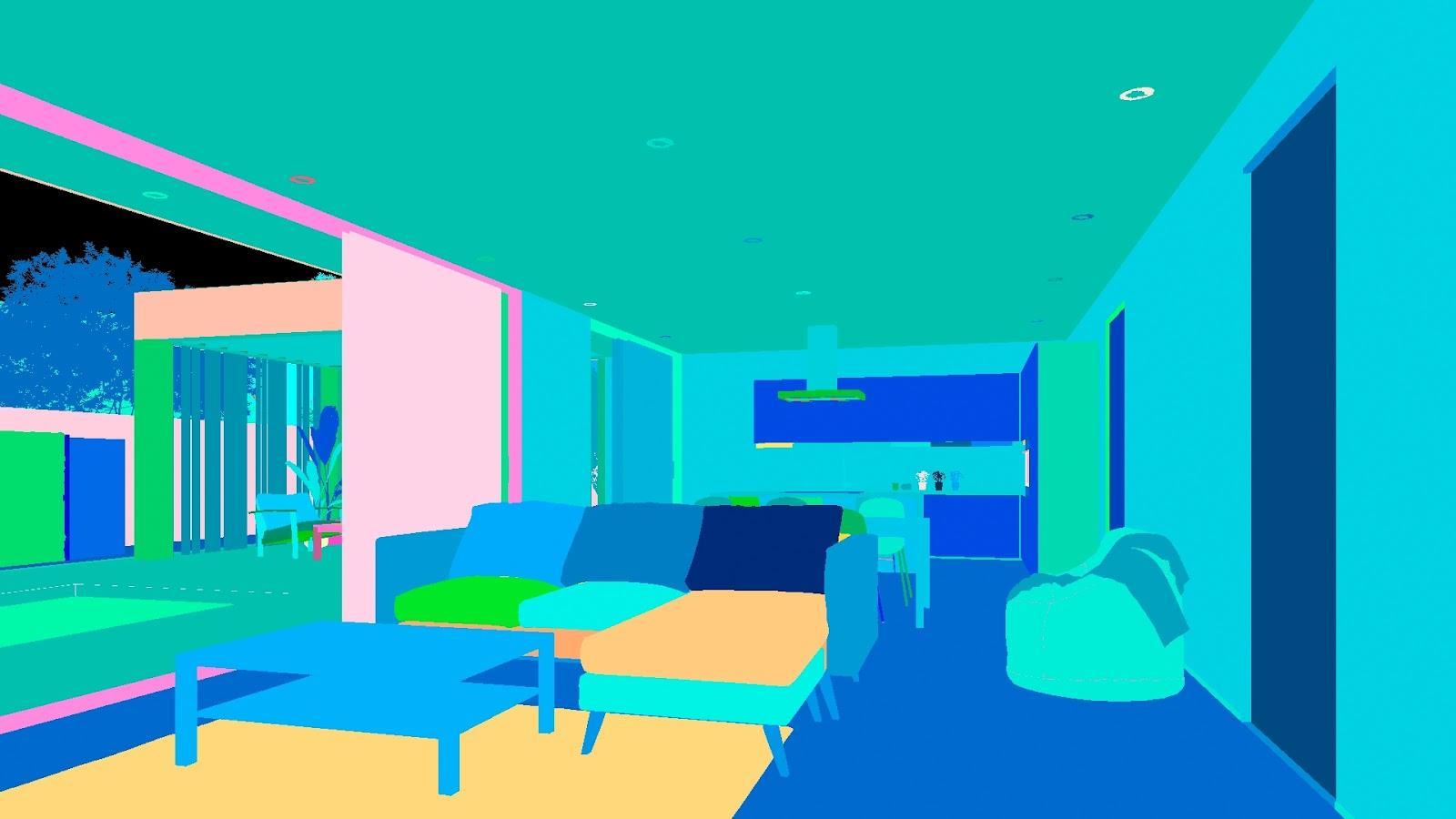

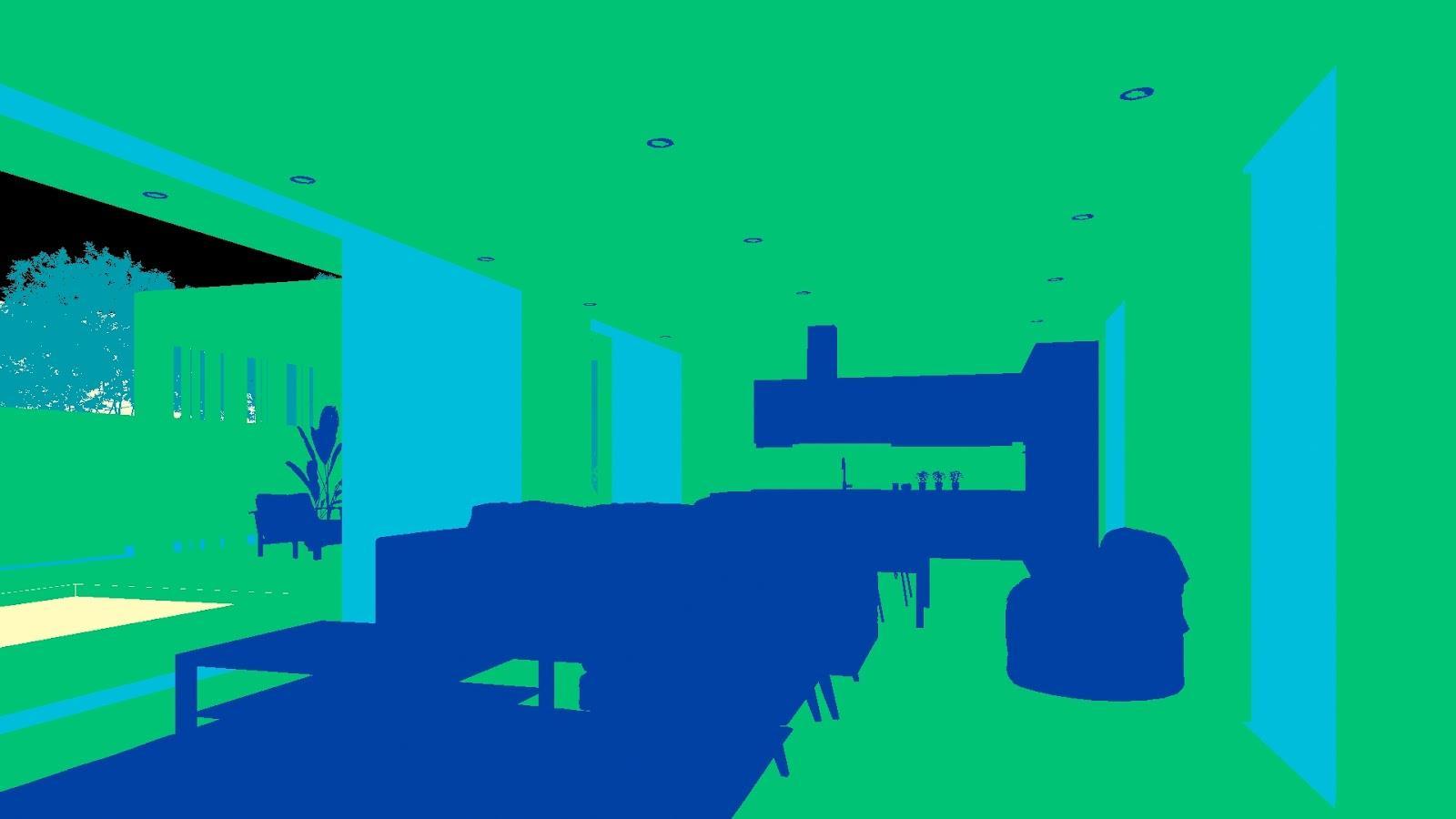

What the Cryptomatte pass looks like when rendered.
Note: what you see in the VFB is just a preview. It is not an accurate representation of the data included in the Cryptomatte element. Some visual artifacts may appear (e.g. when using motion blur and DOF), and the colors may not appear to be distributed correctly, but this does not affect the usability of the element in post-production.

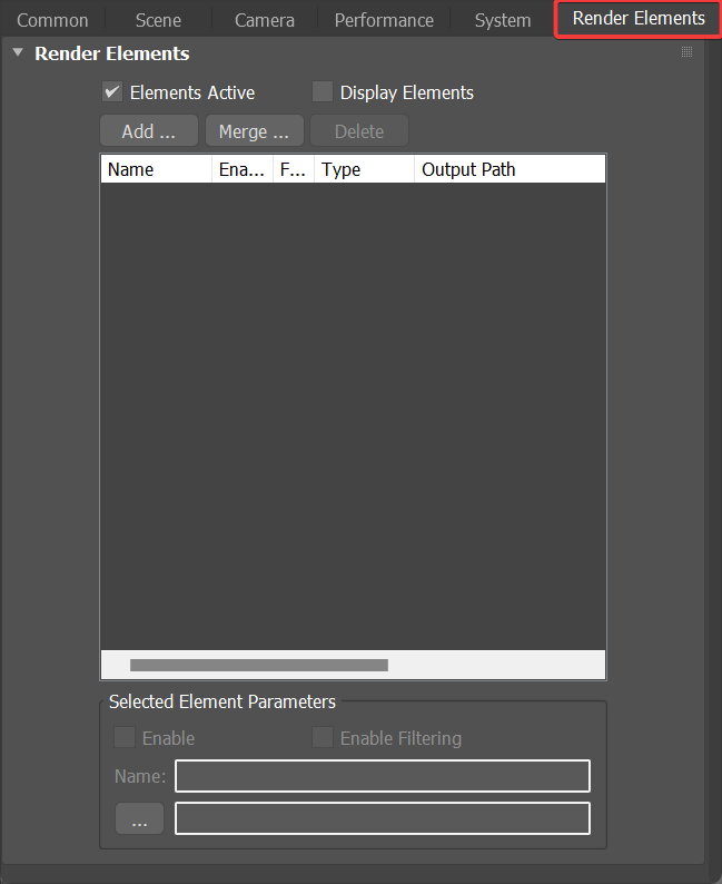

1. Press F10 in 3ds Max to open Render Setup and then navigate to the “Render Elements” tab:

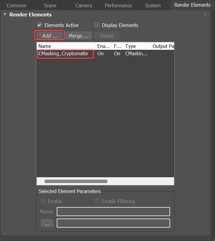

2. Click on the add button and select the CMasking_Cryptomatte render element:
In the Render Setup Window > Render Elements > Add > CMasking_Cryptomatte.

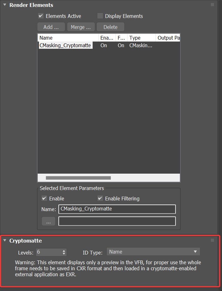

The Corona Cryptomatte Parameters:

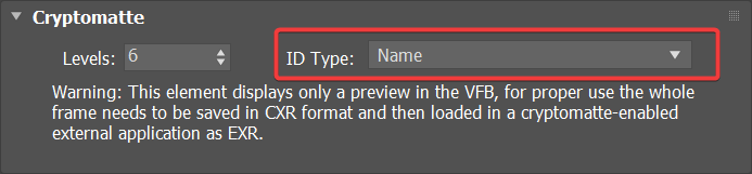

Levels: Determines how many different objects can be identified by the Cryptomatte render element in a single pixel. By default, this value is set to 6.
ID Type: This parameter determines how many objects are distinguished in the Cryptomatte pass.

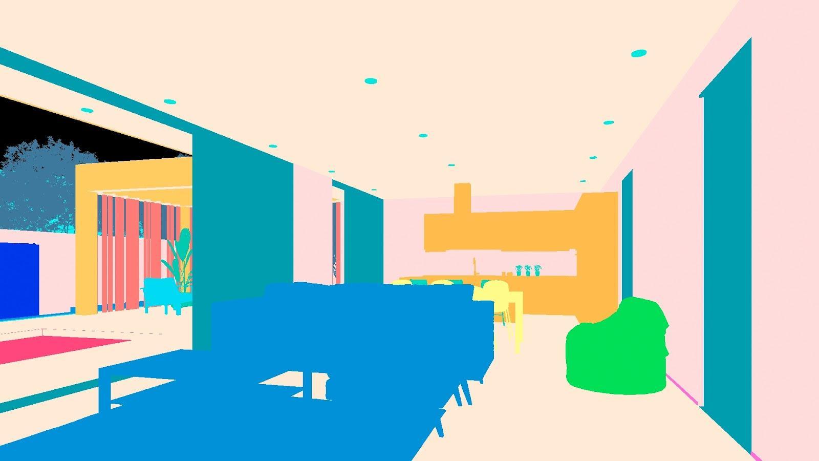

1. Name: Using this mode, only objects with the same name will have the same color. This means that if all of your scene objects have different names, different colors will be assigned to each one of them.
Example:
image-006.jpgThis is the resulting Cryptomatte pass when the ID type is set to "Name"

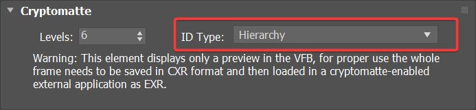

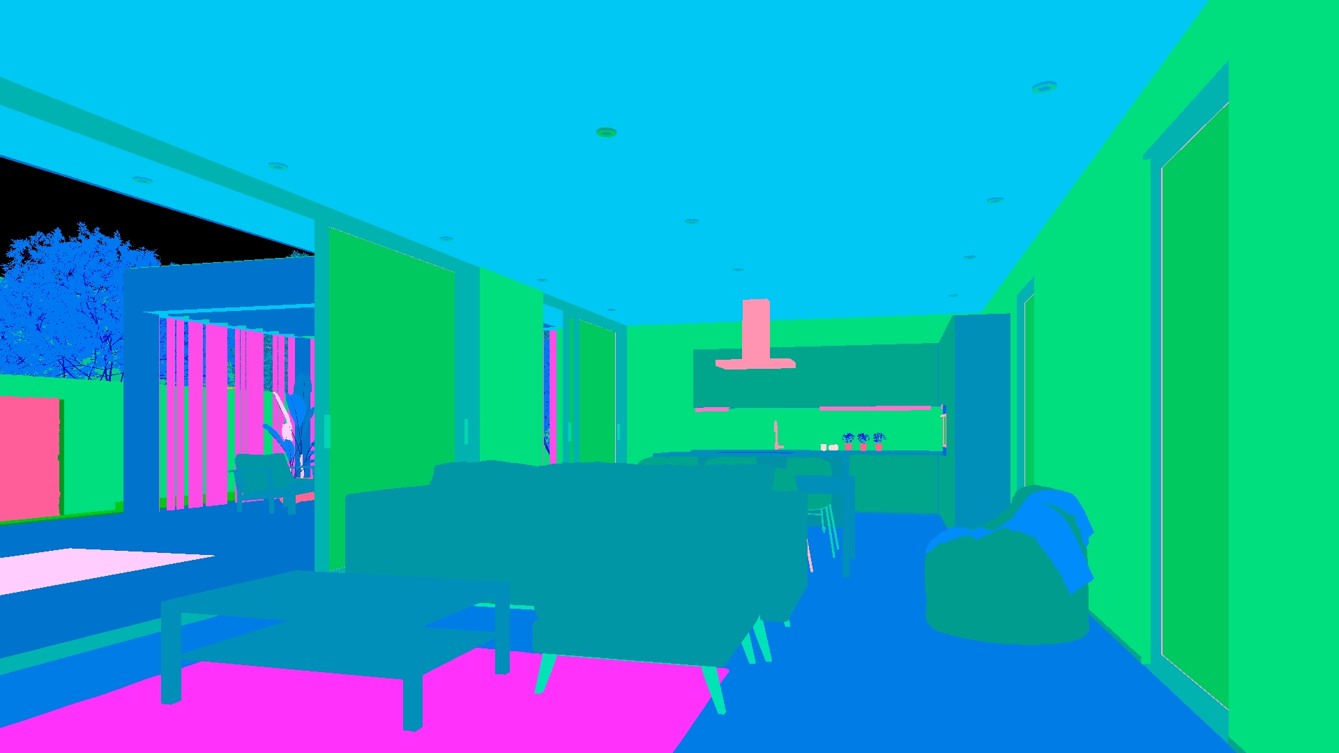

2. Hierarchy: Using this mode, only objects with the same name and in the same group hierarchy in the object manager will have the same color.
Example:
image-008.jpgThis is the resulting Cryptomatte pass when the ID type is set to "Name with hierarchy"
