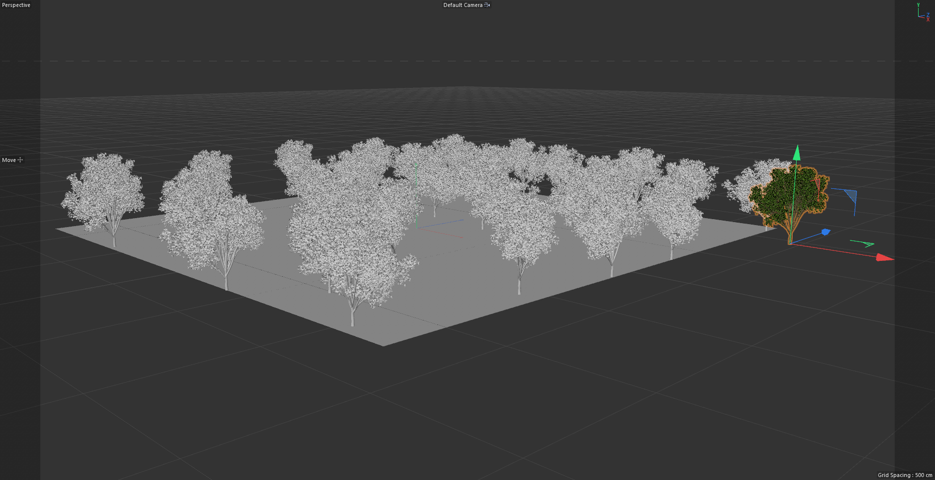

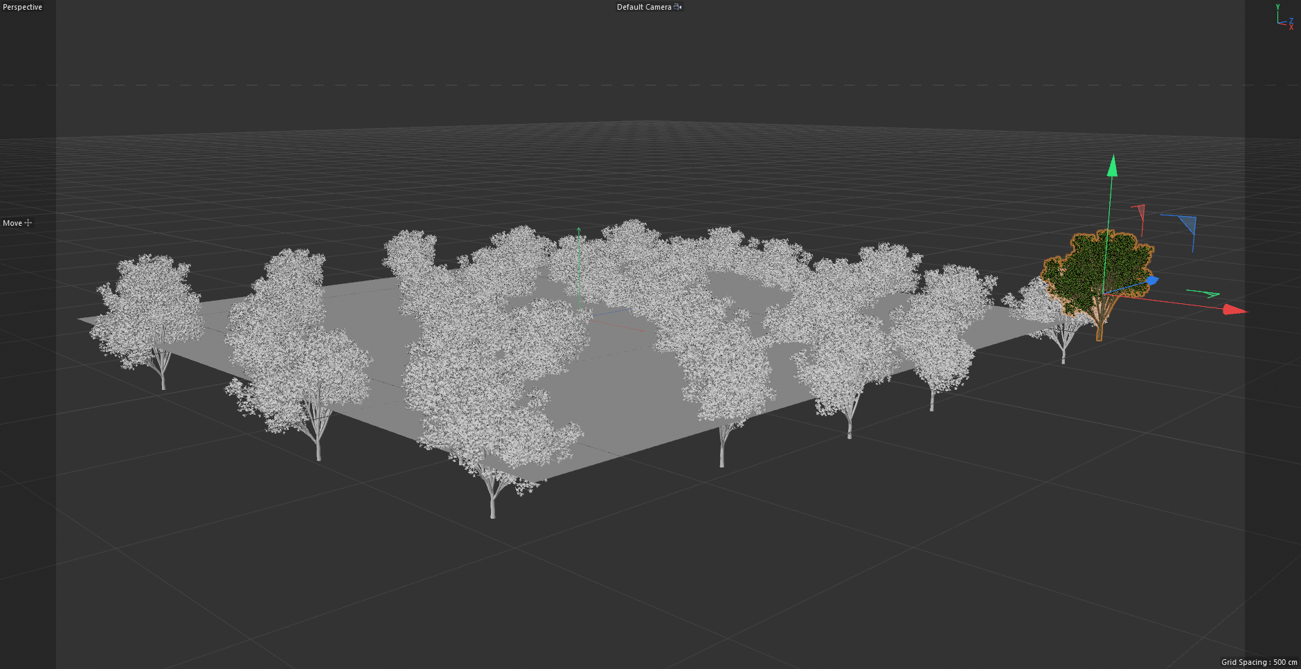

- Keep in mind that multiple levels of detail based on the distance from the camera are not really needed. Let's imagine that we are scattering a complex model of a building on a few-kilometer large plane. A single model of the building requires 100 MB of RAM. Let's take a look at a few scenarios:
- Case 1 - there is no scattering at all and the building model is in the scene:
The building model takes 100 MB of RAM. The total RAM usage is 100 MB. - Case 2 - the single building model is scattered:
The building model takes 100 MB of RAM. Each scattered instance adds just a tiny bit more to the required RAM. The total RAM usage is 100 MB + a little bit more. - Case 3 - the original building model is in the scene, and additionally an optimized building model is in the scene, which requires only 50% of the original model's RAM usage:
The original building model takes 100 MB. The optimized building model takes 50 MB. The total RAM usage is 150 MB. - Case 4 - the original and optimized building models are in the scene. The original building model is scattered close to the camera. The optimized model is scattered farther away from the camera:
The original model takes 100 MB. The optimized model takes 50 MB. The scattered instances add a bit of RAM usage to the scene. The total RAM usage is 150 MB + a little bit more.
Conclusion: as you can see, the least RAM is used when only the original building model is scattered, and this is not only the easiest and the fastest to set up but also the most efficient and correct approach. Adding more versions of the same model with different levels of detail will only add to the overall RAM usage and will require some extra work (manually optimizing the models, and/or adding the different models into the scatter and placing them in the right distance ranges from the camera).

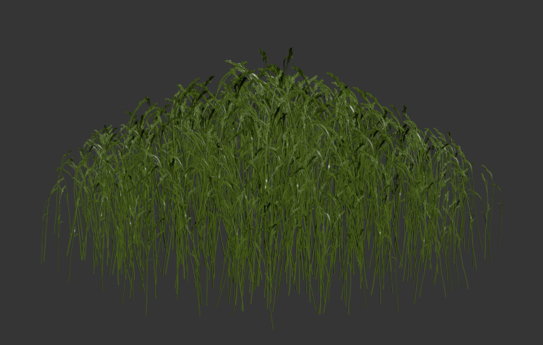

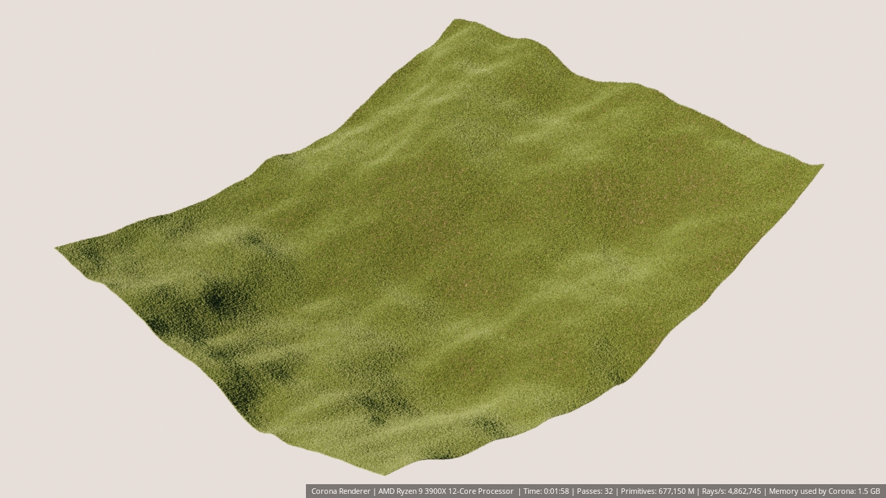

- In case of dense scattering on a large surface (e.g. grass), always scatter a clump of smaller objects rather than a single small object (e.g. a clump of grass blades rather than a single grass blade). Scattering a single mesh consisting of multiple elements rather than a single element is always better in terms of RAM usage. Here is an example:
Case 1 - Scattering a single mesh, which is a clump of grass blades:
The result:
RAM usage: 1.5 GB

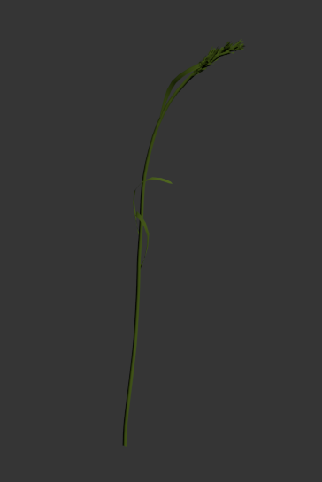

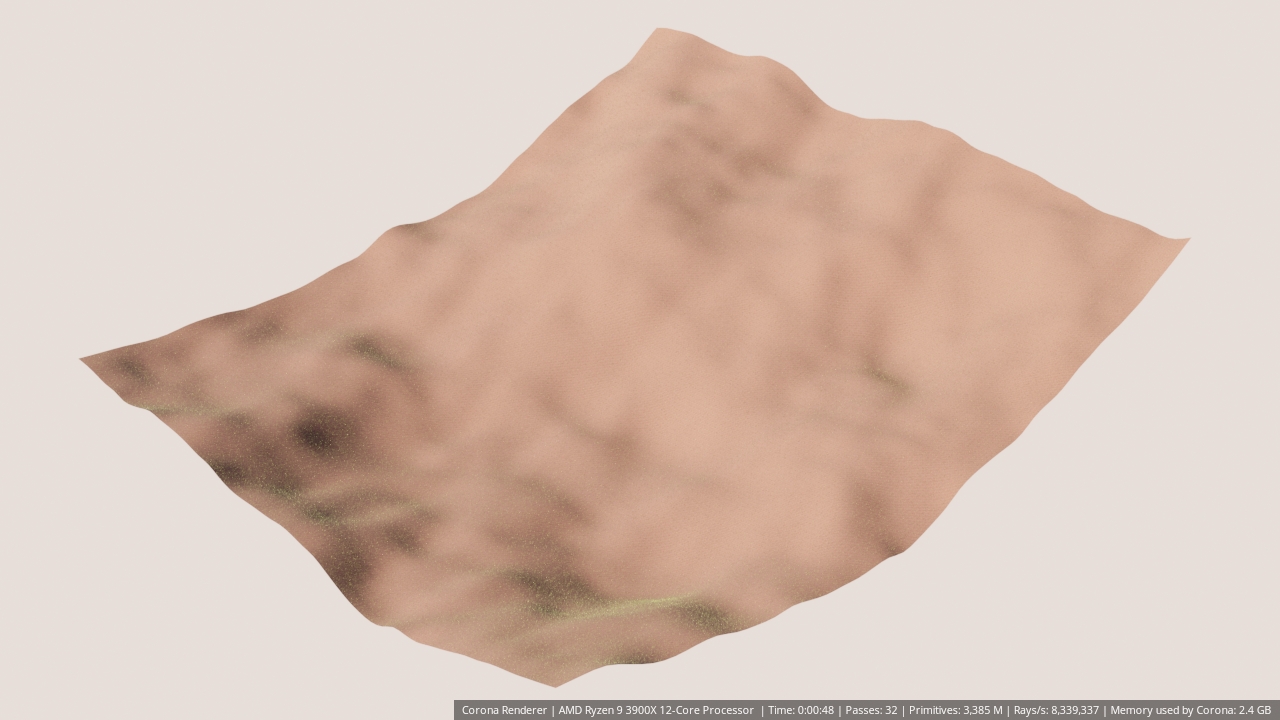

Case 2 - Scattering a single mesh, which is a single grass blade:
The result:
RAM usage: 2.4 GB
Note that the scattering is much, much sparser than in the case of scattering a clump, but the RAM usage is already higher.

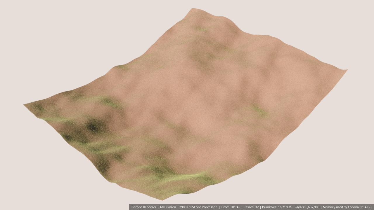

Case 3 - Scattering a single mesh, which is a single grass blade, number of scattered instances increased:
RAM usage: 11.4 GB
We can try to cover a larger area with individual grass blades, but even with very high count values, this won't give us a satisfying result, and at the same time will cause an extreme increase in RAM usage:

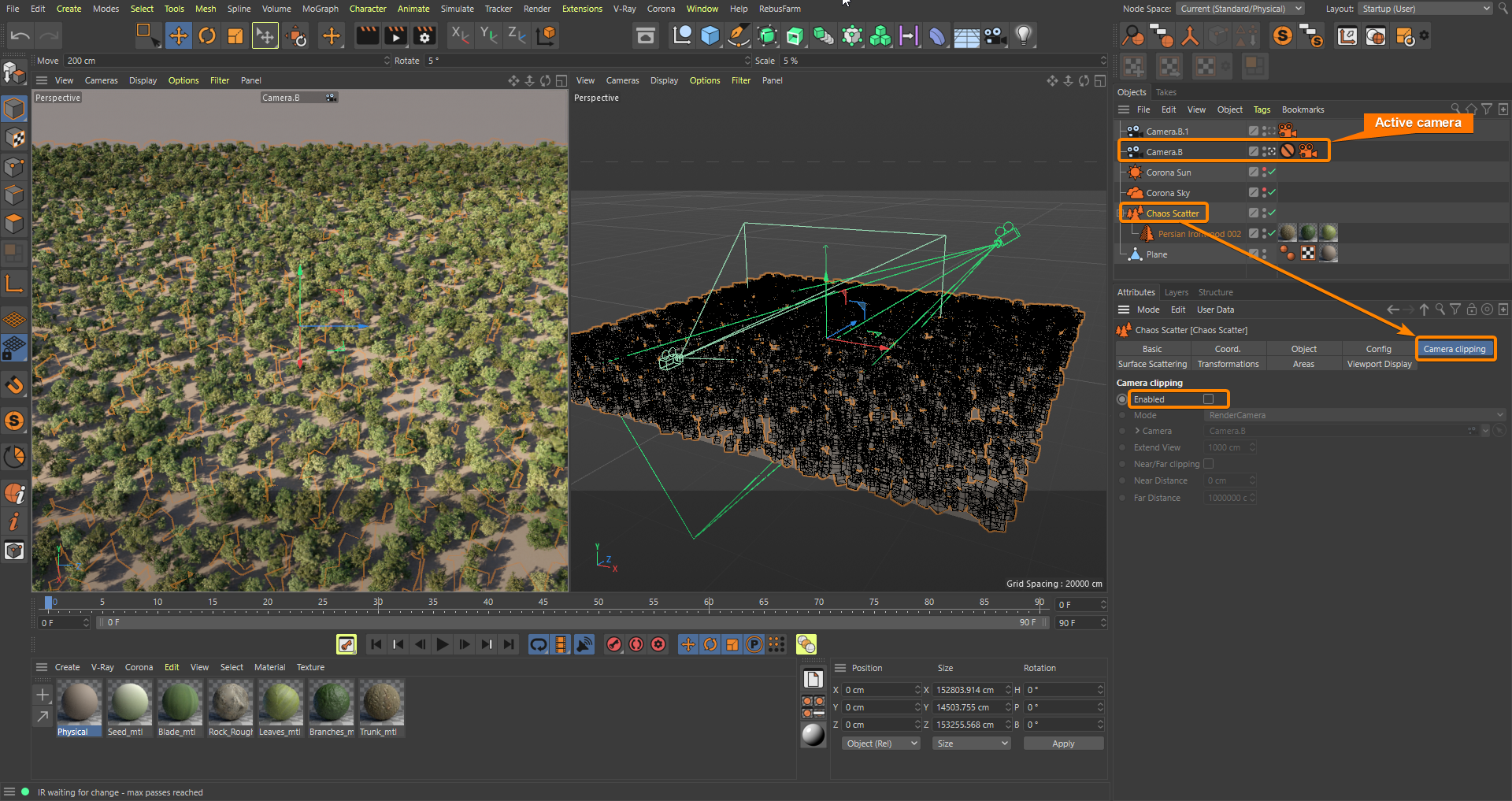

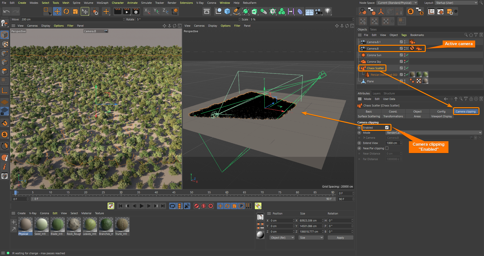

Camera Clipping
Camera clipping limits the scattering to the camera view. Instances that are not visible will be clipped away. It is an optimization that may improve scene parsing speed and lower memory usage, however, it can cause missing reflections or shadows. To learn more, see the "Camera Clipping" section in this article.
