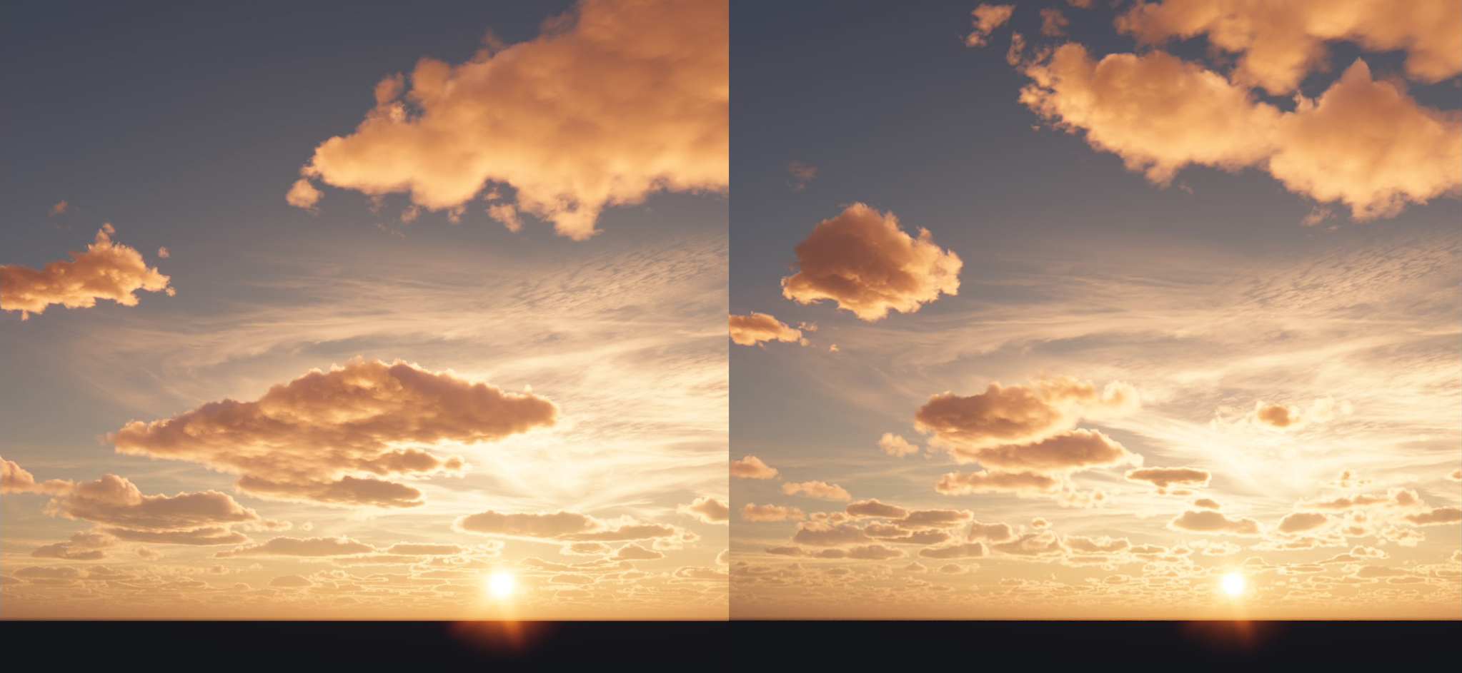

If we lower the Sun closer to the horizon, we will see that the Clouds get illuminated with orange-red colors, like during a sunset:
Another Sun position:
