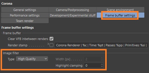

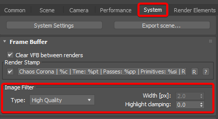

DOF Highlights Solver works best with "High Quality" image filter. Nevertheless, you can safely ignore this message and continue rendering with the current settings.
To get the lowest amount of noise in your rendered image and the highest rendering performance, always use the DOF Highlights Solver (Max | C4D) with image filtering type set to High Quality (Max | C4D). In case of using other image filter types, the rendering will continue without any major issues, but the noise may be more pronounced, and the overall performance may be lower.
3ds Max:

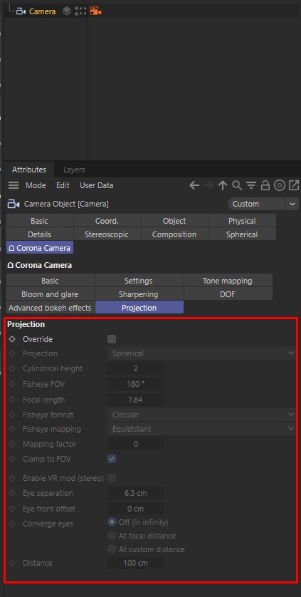

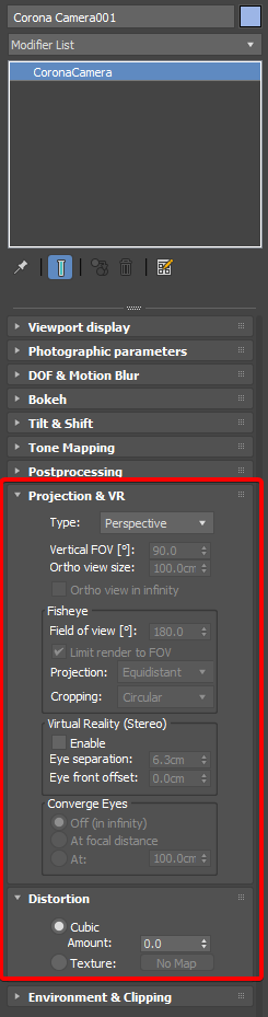

    Disable any VR and distortion effects in the camera you are rendering from:
    3ds Max:
    Cinema 4D:
    DOF

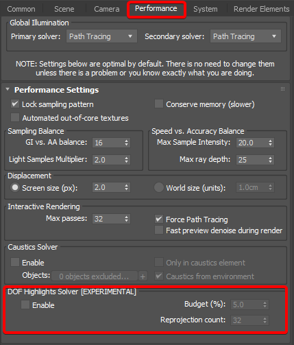

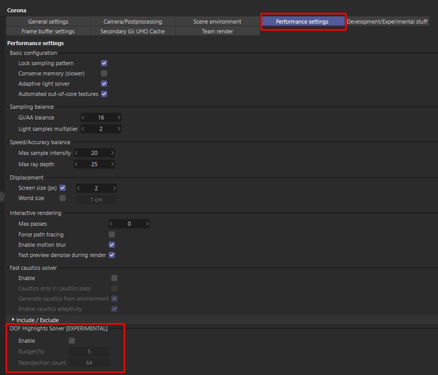

  • If you wish to use any VR or distortion effects in the camera you are rendering from:
    Disable the DOF Highlights Solver in the Performance tab:
    Cinema 4D:
    DOF
