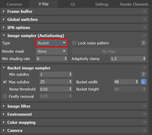

  • Use the Bucket image sampler
V-Ray is equipped with Bucket and Progressive Image Sampler modes. While Progressive mode has many advantages, it needs to load all assets into the memory. The Bucket mode on the other hand is much more memory efficient as it needs to load only the information required to render the current bucket.
Preview of the Bucket type setting's location in 3ds Max
How to:
  • V-Ray for 3dsMax: Render Setup > V-Ray > Image Sampler (Antialiasing) > Type
  • V-Ray for Maya: Render Settings > VRay > Image Sampler > Sampler type
  • V-Ray for SketchUp / Rhino: V-Ray Asset Editor > Render > Progressive Slider off
  • V-Ray for Revit: V-Ray > Settings > Renderer > Sampler
  • V-Ray for Houdini: V-Ray > Render Settings > Renderer > Sampler > Image Sampler > Type
  • V-Ray for Cinema4D: Render Settings > V-Ray > Image Sampler > Sampler type
  • V-Ray for Blender: Render Settings > Sampler > Image Sampler > Sampler type
Note that the bucket size is also something to be considered. A very small size will cause less geometry to be loaded in the Memory. However, that will increase the Render Time due to filtering of the pixels on the Bucket's Edges. The default size is optimized for most scenes.

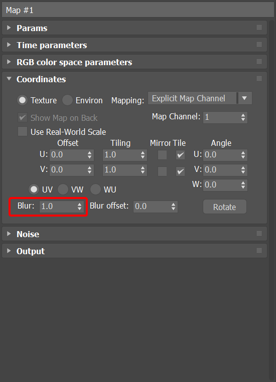

    In 3ds Max, you can choose the mipmap resolutions for the tiled textures by using the Blur parameter in the Coordinates section of the VRayBitmap.
    Preview of the blur parameter's location in 3ds Max
    Smaller values than 1 are not recommended, since they will force higher resolutions to be loaded and possibly, not perform any filtering.
