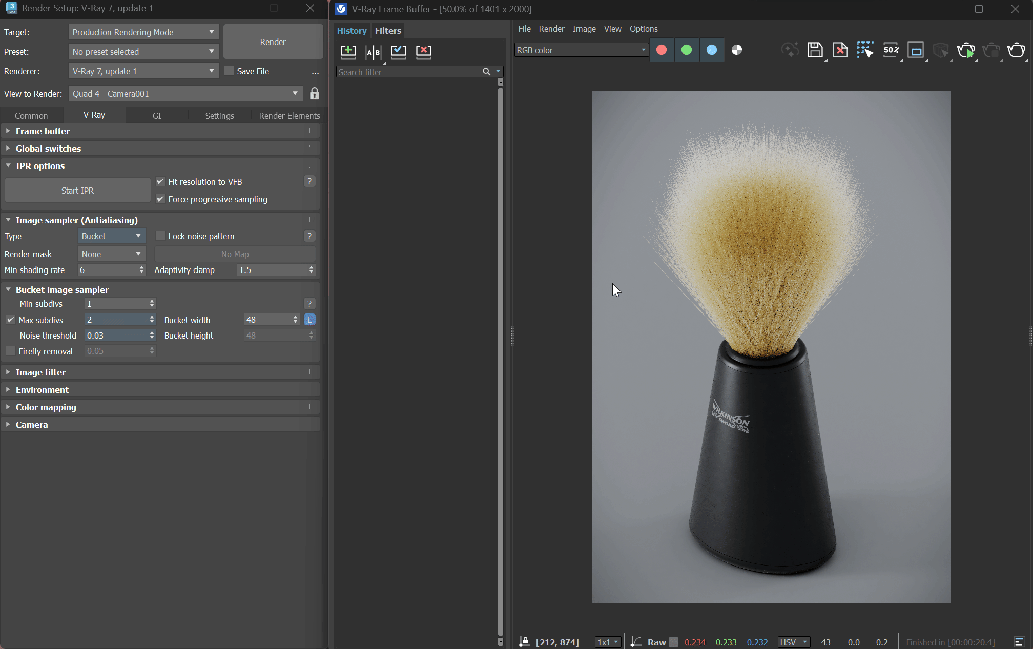

  • Set a smaller image resolution or a region render
  • Use IPR
  • Use Bucket Sampler with Min/Max subdivs of 1

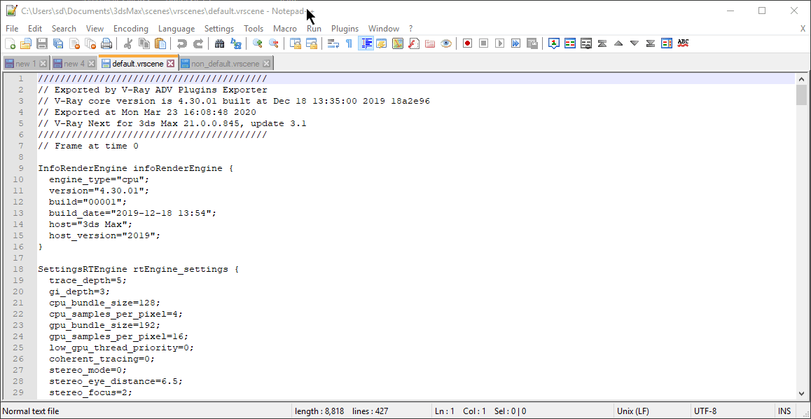

  • Compare Render Settings Using a .vrscene File
    You can manually compare the render settings of several scenes via export to a .vrscene file. To check the differences in the render settings, compare the troublesome scene with a default (empty) scene. Text editors like Notepad++ (with the Compare plugin) could be used for this purpose.
    Here's a step-by-step guide:
    1. Export the original scene to .vrscene file.
    2. Export a new empty scene to a .vrscene file.
      Here's how:
    3. Open both files into a text editor and start the Comparing mode.
    4. Look for sections starting with Settings
      For example:
      SettingsOutput vraySettingsOutput {
      SettingsOptions vraySettingsOptions {
      SettingsImageSampler vraySettingsImageSampler {
      Demonstration of comparing vrscenes
      5. By comparing both .vrscenes you could quickly find the differences between the parameters. These are the potential suspects.

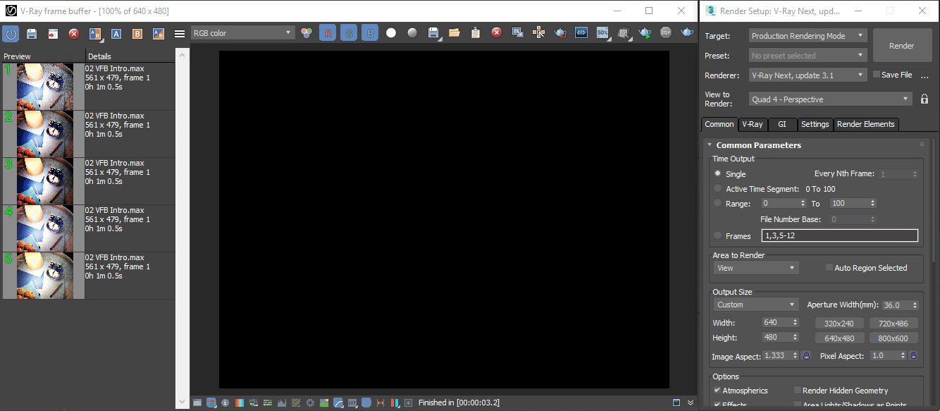

  • Compare Render Settings in the V-Ray Frame Buffer (3ds Max)
    You can compare the current render settings to the render settings of an image stored in the History. It can be used to quickly compare the scene's Render Settings with the Defaults.
    To do that:
    1. Render the scene with the original settings
    2. Save the output in the VFB History
    3. Reset the Render Settings
    4. Right-click on the image in the History window and select Compare V-Ray Settings
    5. A new window pops up and displays the current scene's settings with the ones saved in the image.
Deomnstration
