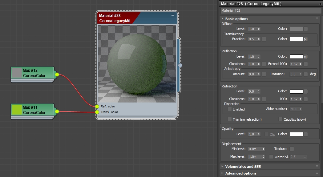

Incorrectly set up material:
Refraction is used with Translucency, which is incorrect. The converted Corona Physical Material looks different than the original.
Before conversion:
After conversion:
Note: As you can see, the Corona Converter tries to keep all the information of the original material (Diffuse, Translucency, Reflection, and also their multiplications) in the newly created nodes, also naming them accordingly. This gives you a better view of the settings used and lets you modify them more easily.

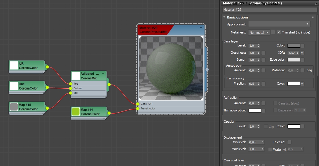

Correctly set up materials:
Refraction is NOT used for a translucent material in this case (correct model for grass, leaves, paper etc.). The converted Corona Physical Material looks identical to the original material. Also note that the Thin shell (no inside) option is enabled for the Corona Physical Material, as "Enable Thin shell if translucent" option is checked in Corona Converter options.
Before conversion:
After conversion:
Note #1: Again, the Corona Converter kept all the settings in the nodes for better view and easy tweaking.
Note #2: There is no Reflection color parameter in the Corona Physical Material. Corona Physical Material's reflectivity is controlled with Base IOR or Specular (for non metals). For this, the original Corona Color for Reflection color is mixed with other parameters of Corona Legacy Material's reflectivity through Corona Mix and plugged into the Base IOR for Corona Physical Material.
