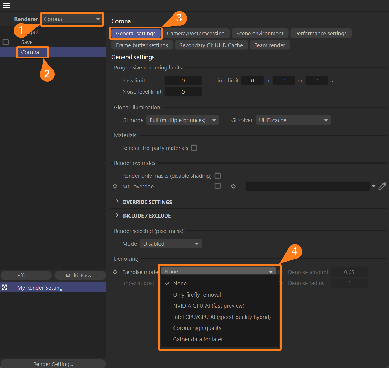

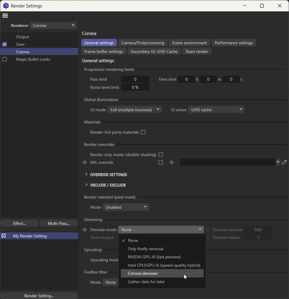

Enabling denoising
Denoising can be enabled under Render Settings > Corona > General settings > Denoising:
Enabling denoising in render settings and available denoising modes. Click to enlarge.
Available denoising options include:

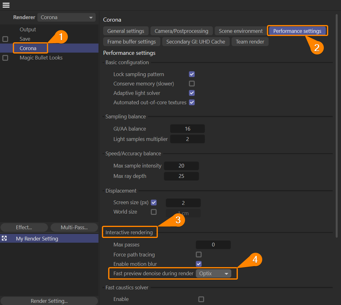

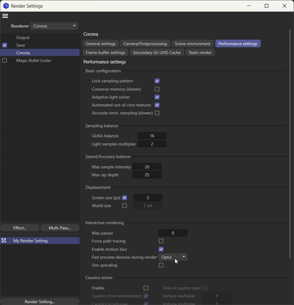

For Interactive rendering:
The Intel GPU AI or NVIDIA GPU AI denoiser can be selected from:
Render Settings > Corona > Performance settings Tab > Interactive Rendering > Fast preview Denoise during render:

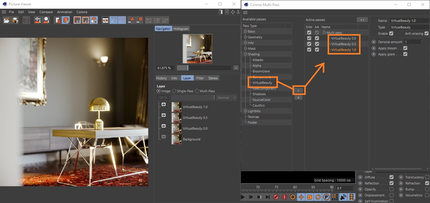

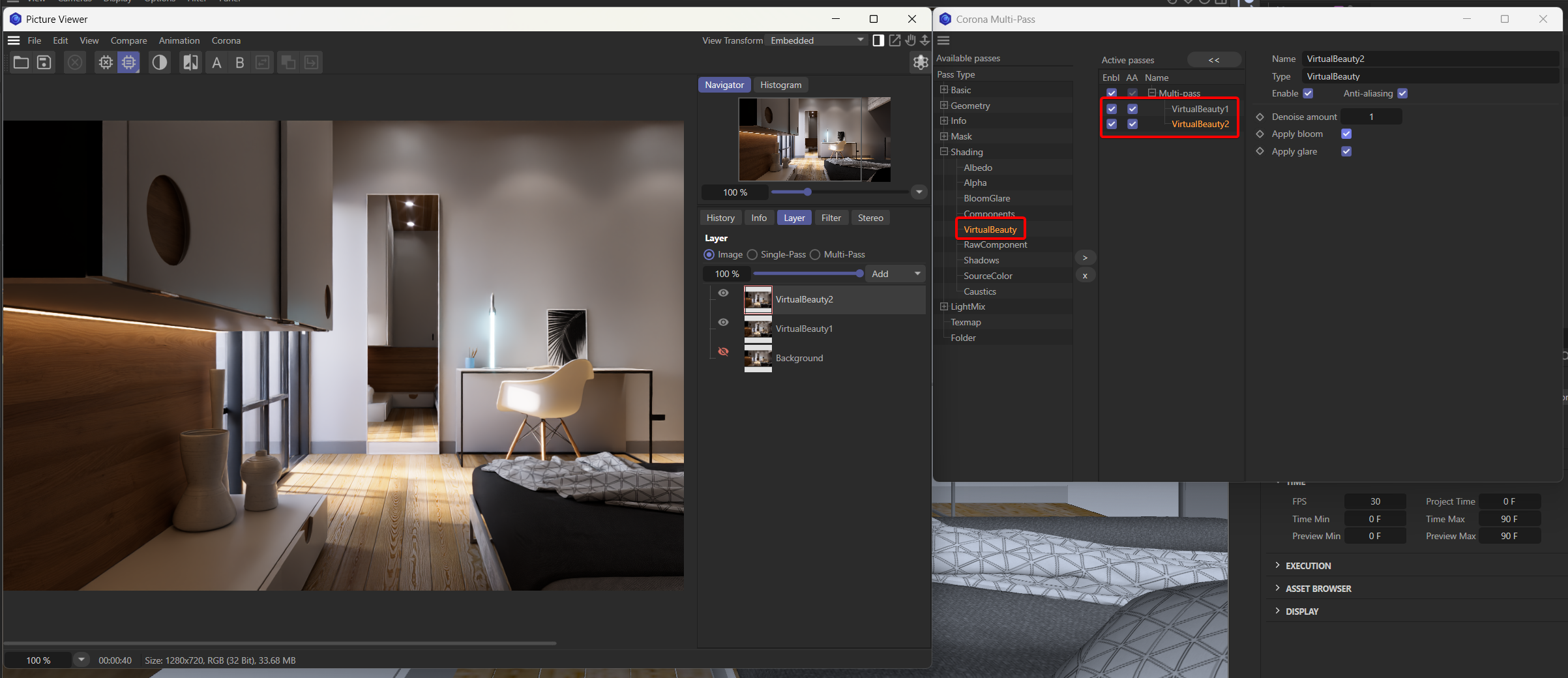

5. Saving multiple versions of the rendering with different denoising amounts
Multiple "VirtualBeauty" passes can be used to save different versions of the same image at once with various amounts of denoising applied. This allows you to use masks (either generated from Corona or created manually) to blend between different denoising amounts in post, for example, if you wish to preserve flakes in car paint or fine bump mapping in carpets that might need a lower denoising level than other parts of the image. Individual denoising amount is specified in the properties of each VirtualBeauty pass regardless of the in-VFB setting:
Multiple VirtualBeauty elements visible on the Corona Multi-Pass list. The denoising value of each of the passes is different than the currently set "denoise amount" in Corona VFB. Click to enlarge.

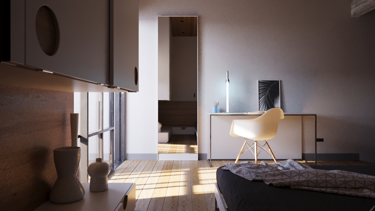

1. Denoising on and off
1.1. Denoising on - interior scene - 10 minutes.
(click to enlarge)

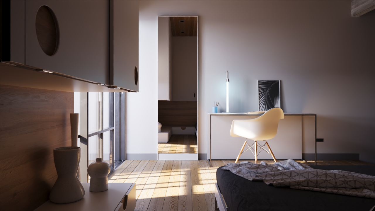

1.3. Denoising on - strong DOF - 10 minutes.
(click to enlarge)

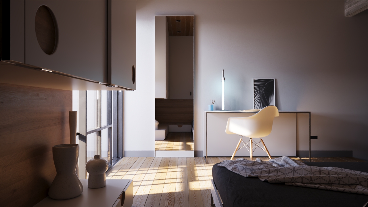

1.4. Denoising off - strong DOF - 10 minutes.
(click to enlarge)
