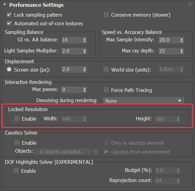

Locking Corona Interactive Rendering Resolution in the VFB
From Corona 12 onward, you can lock the rendering resolution for interactive rendering in the VFB from Render Settings > Performance > Interactive Rendering > Locked Resolution:
This feature helps maintain a consistent resolution during interactive rendering in Corona VFB, making it easier to see changes in your scene without the resolution adjusting automatically.
