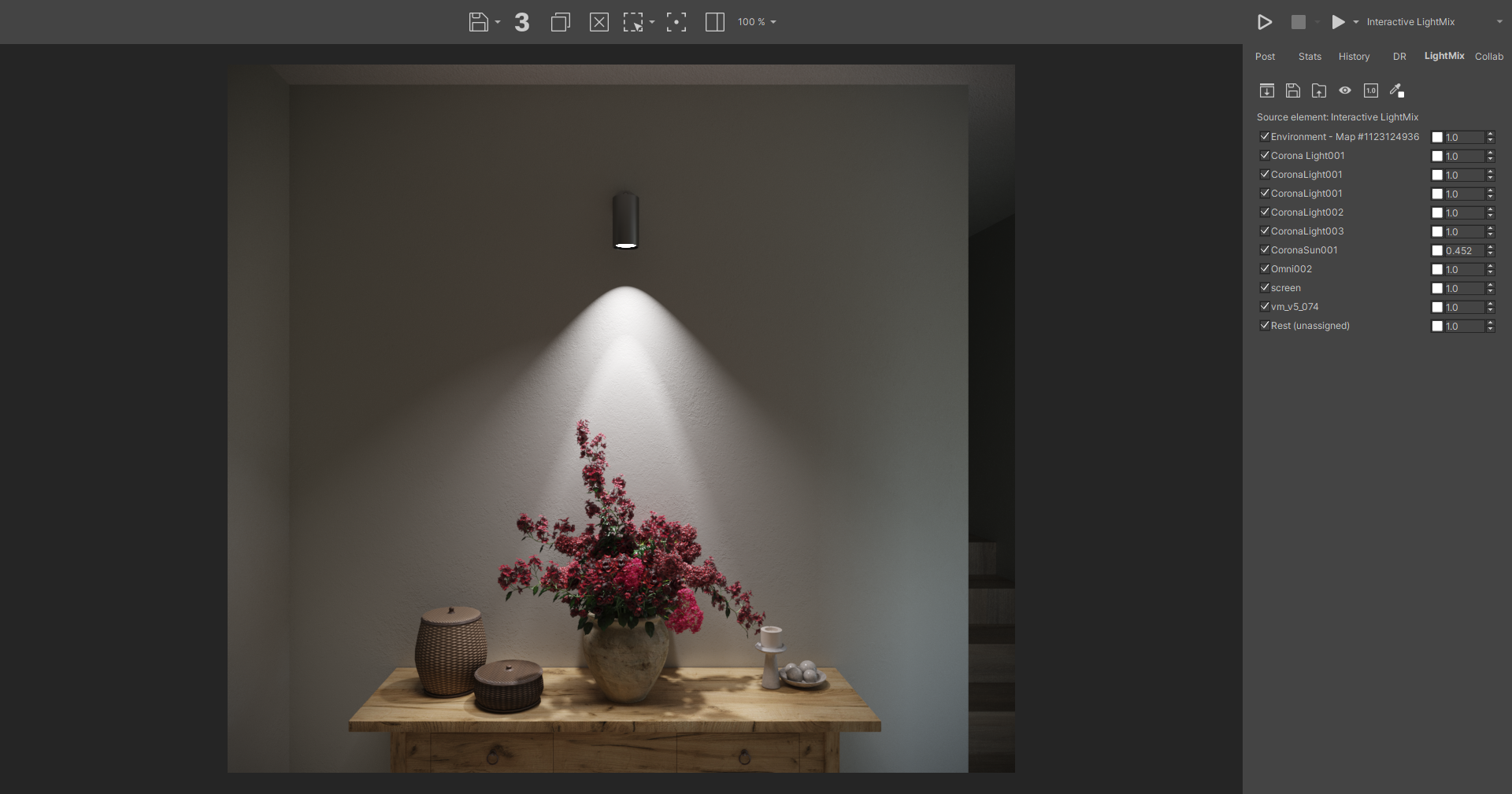

After setting up LightMix (either automatically, or manually), the color and intensity of each light can be changed in the VFB. Simply go to LightMix tab in Corona VFB and change the desired parameters - this can be done during, or after rendering, for both regular and interactive rendering:
After setting up the Interactive LightMix, its dedicated tab in the VFB becomes available

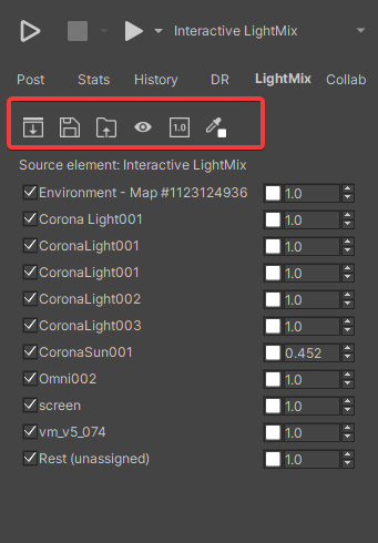

You can also use additional buttons below the lights list:
Button Description
Corona_13_VFB 2.0_LightMix_2_3ds Max.png Bake currently set Lightmix colors/intensities into the scene lights.
Corona_13_VFB 2.0_LightMix_3_3ds Max.png Save settings of the current displayed light mix element to a config file.
Corona_13_VFB 2.0_LightMix_4_3ds Max.png Load light mix settings from a config file to the currently displayed light mix element.
Corona_13_VFB 2.0_LightMix_5_3ds Max.png Enables all entries if some are disabled or disables all if all are currently enabled.
Corona_13_VFB 2.0_LightMix_6_3ds Max.png Set all intensities to 1.
Corona_13_VFB 2.0_LightMix_7_3ds Max.png Set all colors to white.

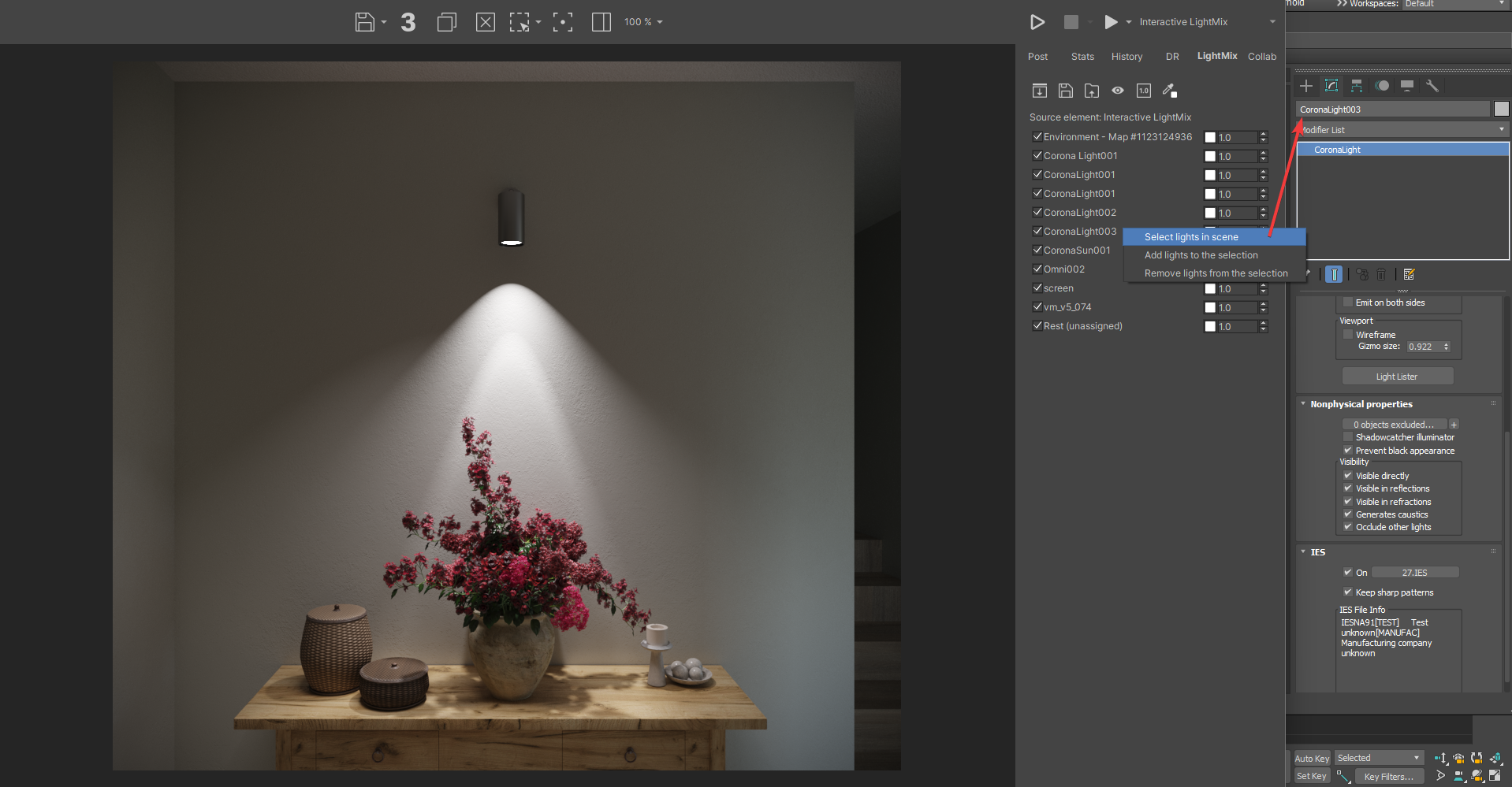

  • You can also right-click on the light names on the LightMix list in the Corona VFB to select a specific light in the scene, add that light to the current selection, or remove that light from the current selection.

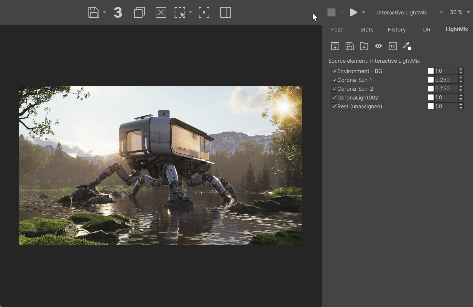

Using LightMix with multiple suns and environments
An example image with multiple suns and environments controlled by LightMix.
In Corona Renderer 4 and newer it is possible to add multiple suns and environment maps to your scene, and then control their appearance with LightMix. This means that you can render just once, and pick between completely different lighting conditions, adjust sun and environment intensity and color, and even have two or more suns illuminate your scene at a time. No re-rendering needed!
See: How to set up multiple suns / environments
