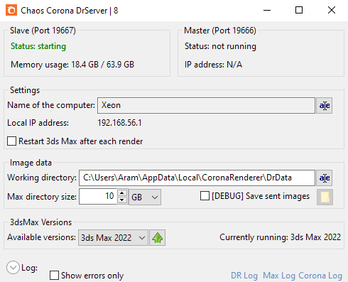

  1. On all render nodes: run the DrServer application
    Note: the DrServer must not be running with elevation (it must not be running "as administrator").
    Do not run DrServer on the master workstation!

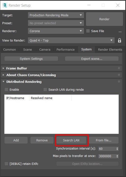

  2. On the master workstation: in 3ds Max, go to Render Setup > System > Distributed Rendering, tick the "Enable" checkbox, and press "Search LAN":

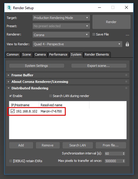

  3. On the master workstation: wait for the addresses or names of your render nodes to appear on the list (or enter their network names or IPs manually using the "Add" button at the bottom):

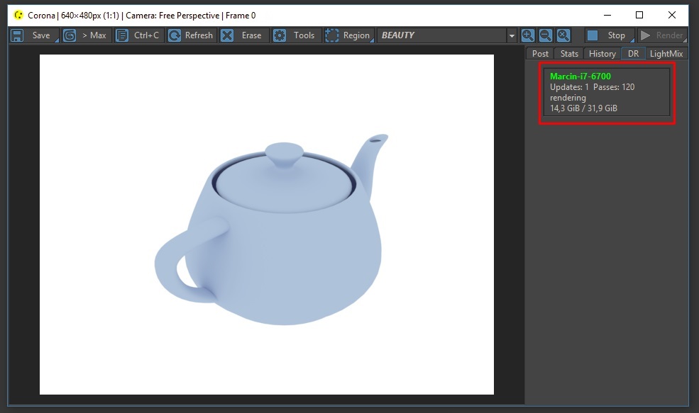

  6. On the master workstation: you can see Distributed Rendering information in the DR tab of the Corona VFB:
