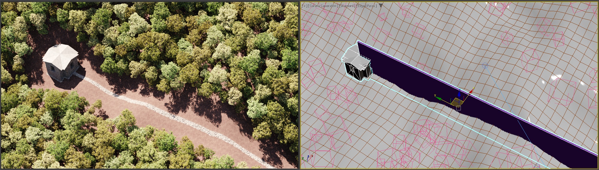

Any map can be used to affect the scattering density (and other properties), including the powerful Corona Distance Map. A typical example is keeping some objects, such as trees or grass, away from buildings or paths. In the below example, we have a forest made with Scatter, and we are keeping the trees away from the building and the path thanks to the Corona Distance Map:
In this case, the Distance map is using the house and the path (a non-renderable box) as the "distance from" objects. Any areas close to those objects are colored black, and the areas farther away are colored white. This map is then used as the density map in Scatter:
