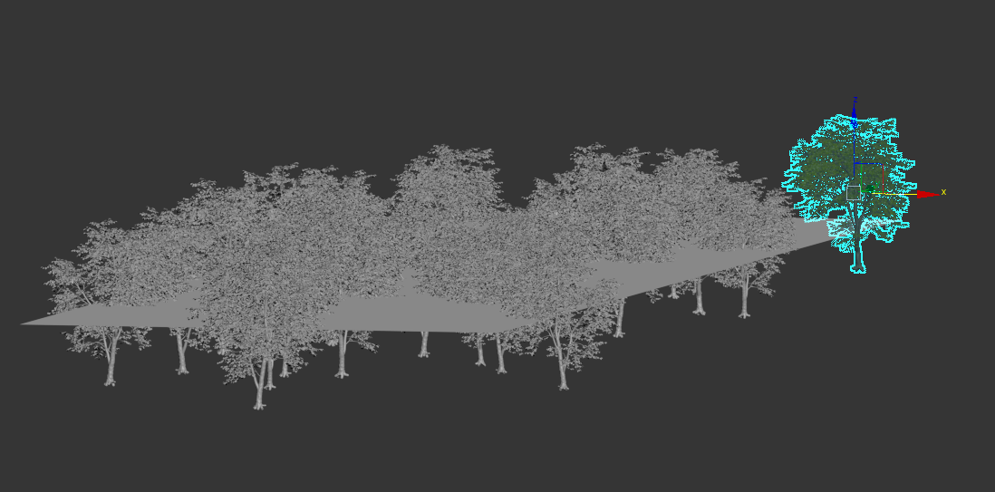

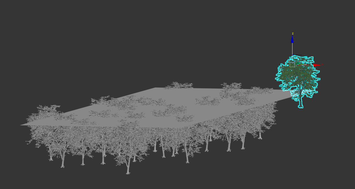

  • In case you see that the instanced model objects you want to distribute on the target object are placed in a "weird" way, for example, from the middle of the tree trunk or located under the target object please make sure that the Pivot Point is at the right place.
    Case 1 - Pivot Point is located in the center of the object:
    The pivot point defines the point which is scattered on the target object so the trees will be growing inside the ground plane.
    Case 2 - Pivot Point is on top:
    In this case the trees are visibly placed too low.

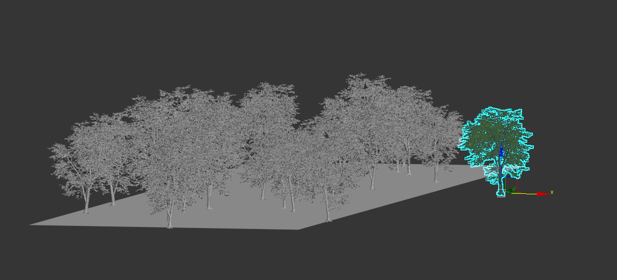

    Case 3 - the correct position of Pivot Point:
    If the pivot is placed at the base of the tree trunk, the objects will be scattered as expected.

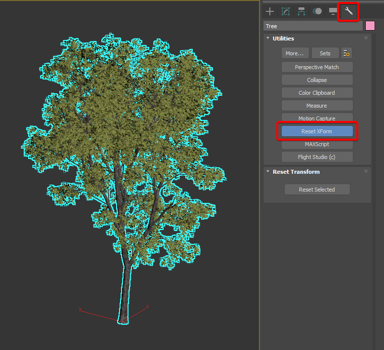

  • If you made some modifications to your model object, like scaling it, make sure you use the Reset XForm Utility to align the object Pivot Point with the World coordinate system. It will remove all Rotation and Scale values from selected objects and place those transforms in an XForm modifier:

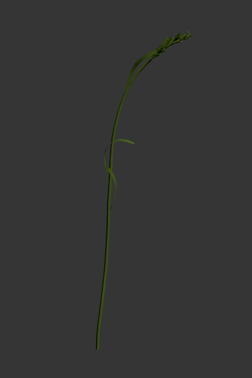

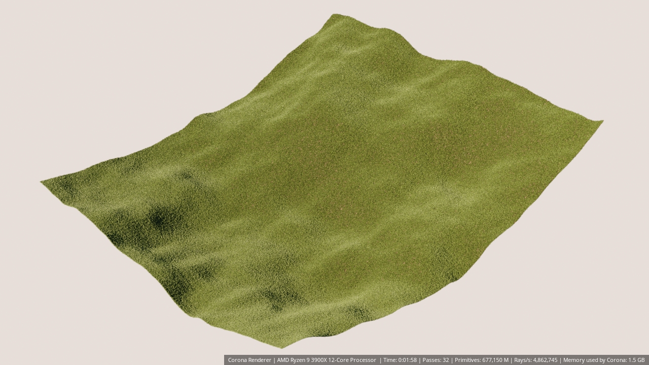

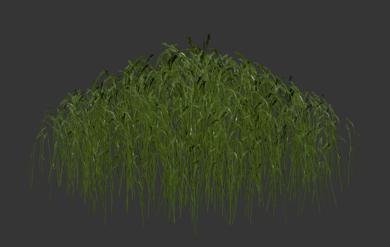

    In case of dense scattering on a large surface (e.g. grass), always scatter a clump of smaller objects rather than a single small object (e.g. a clump of grass blades rather than a single grass blade). Scattering a single mesh consisting of multiple elements rather than a single element is always better in terms of RAM usage. Here is an example:
    Case 1 - Scattering a single mesh, which is a clump of grass blades:
    The result:
    RAM usage: 1.5 GB

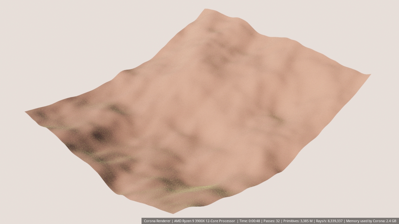

    Case 2 - Scattering a single mesh, which is a single grass blade:
    The result:
    RAM usage: 2.4 GB
    Note that the scattering is much, much sparser than in case of scattering a clump, but the RAM usage is already higher.

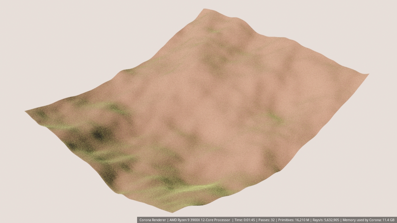

    Case 3 - Scattering a single mesh, which is a single grass blade, number of scattered instances increased:
    RAM usage: 11.4 GB
    We can try to cover a larger area with individual grass blades, but even with very high count values, this won't give us a satisfying result, and at the same time will cause an extreme increase in RAM usage:

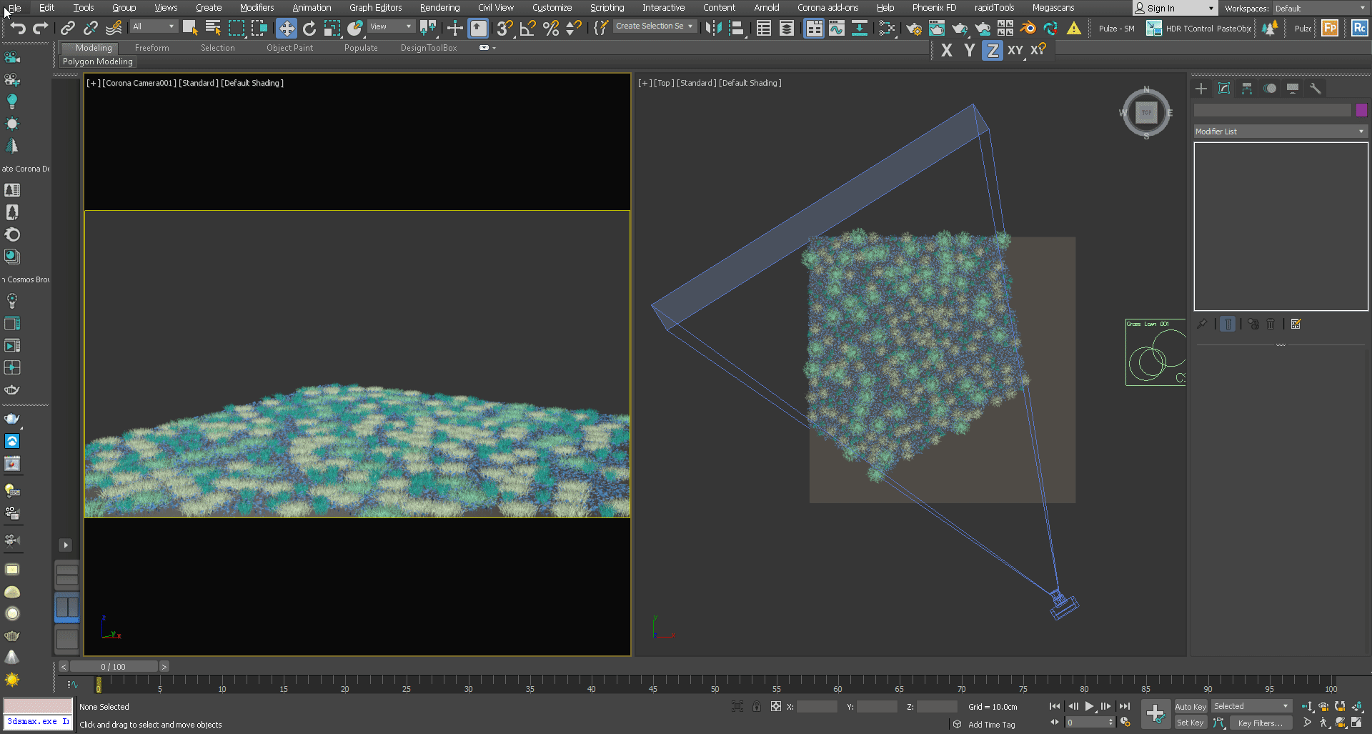

Camera Clipping
Missing Reflections or Shadows
Camera clipping limits the scattering to the camera view. Instances which are not visible are clipped away. It is an optimization which may improve scene parsing speed and lower memory usage, however it can cause missing reflections or shadows. To learn more, see the "Camera Clipping" section in this article.
