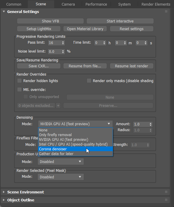

Enabling Denoising

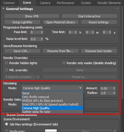

For Production rendering:
Production denoisers can be selected under Render Setup > Scene > General Settings > Denoising > Mode:

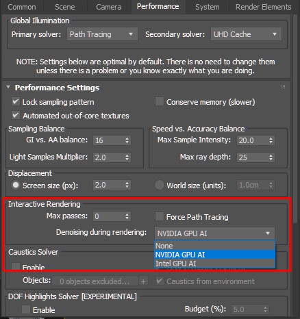

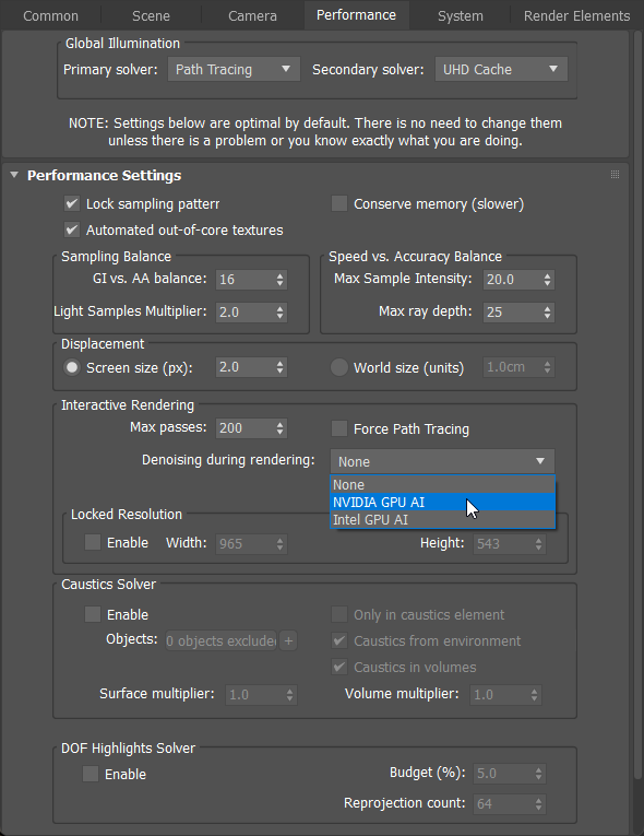

For Interactive rendering:
The Intel CPU / GPU AI or NVIDIA GPU AI denoisers can be selected under Render Setup > Performance > Performance Settings > Interactive Rendering > Denoising during rendering:

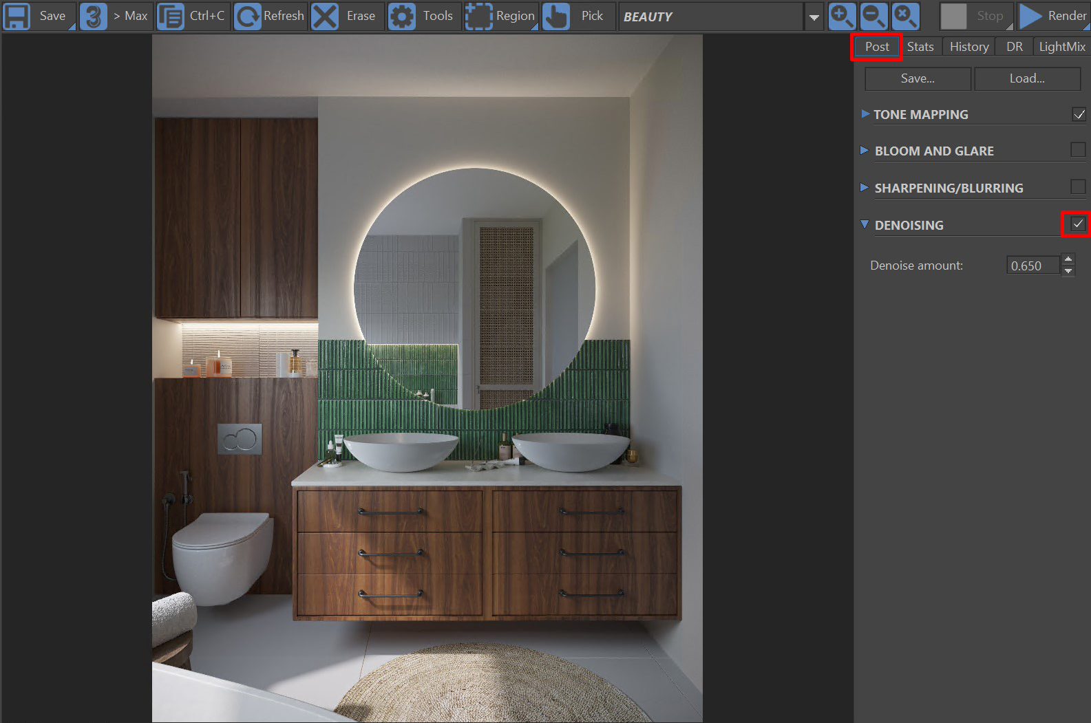

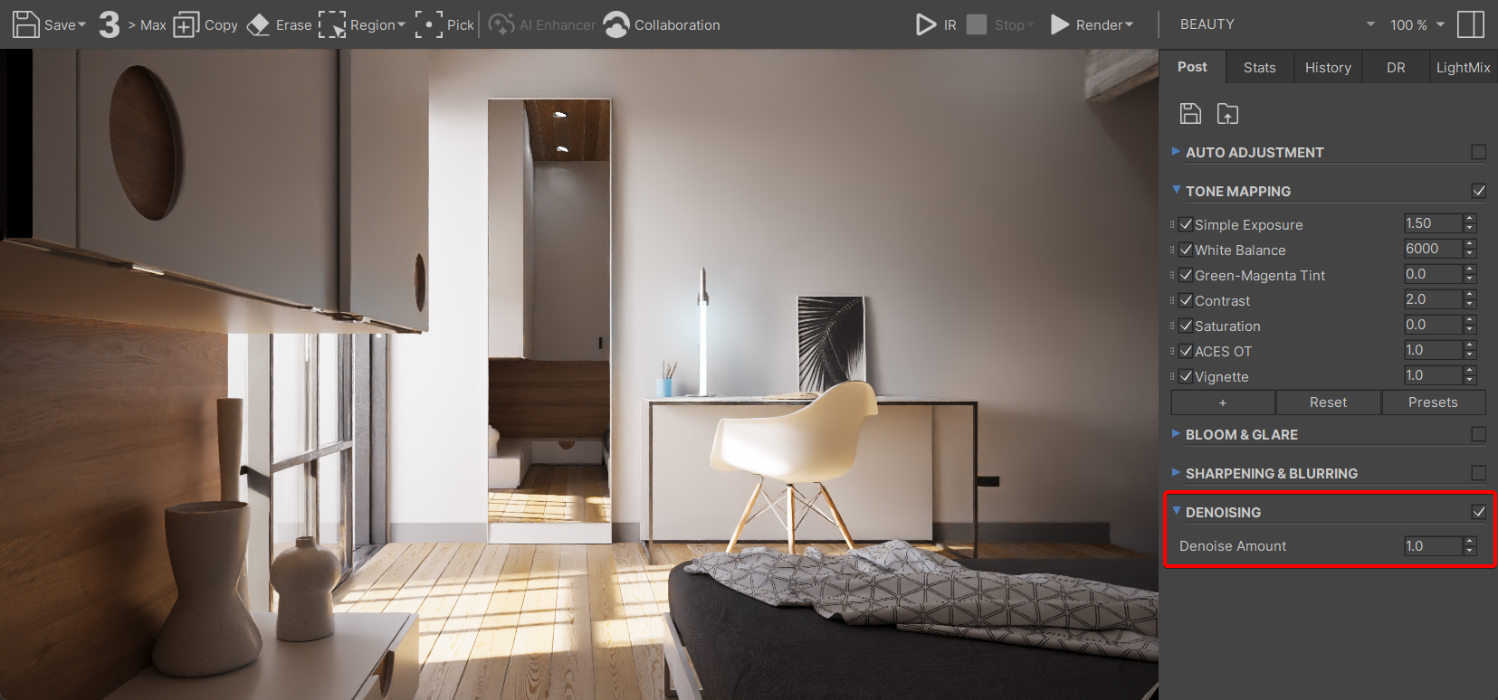

Denoising Checkbox
You can switch between the raw before-denoising render and the denoised image, using a checkbox in the VFB and in the Corona Image Editor. This lets you switch denoising on and off so that you can easily compare the differences.

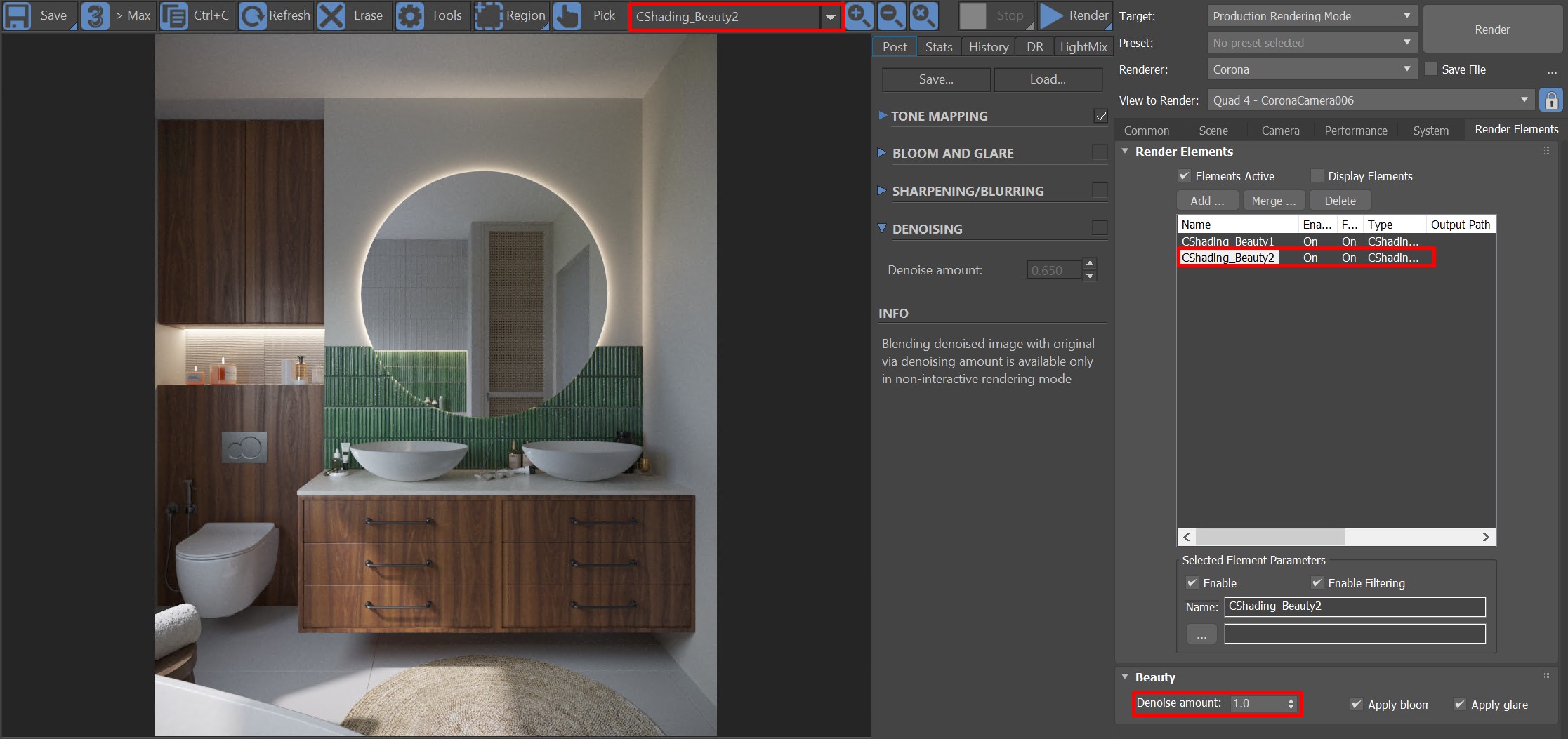

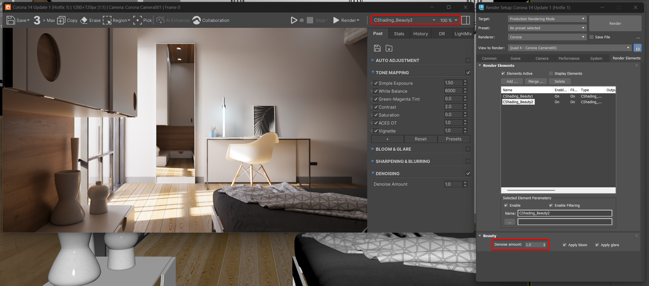

3. Saving multiple versions of the rendering with different denoising amounts
Multiple "CShading_Beauty" render elements can be used to save different versions of the same image at once with various amounts of denoising applied. Individual denoising amount is specified in the properties of each CShading_Beauty element regardless of the setting in the VFB:
Multiple CShading_Beauty elements visible in the render elements list. The denoising value of each of the elements is different than the "denoise amount" currently set in Corona VFB. Click to enlarge.
