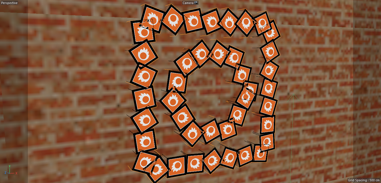

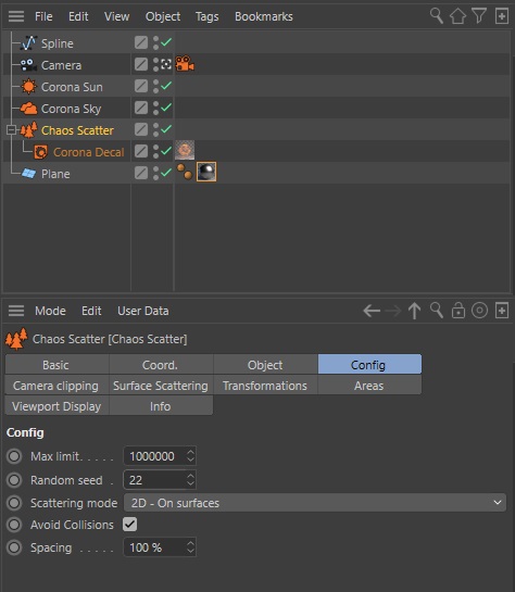

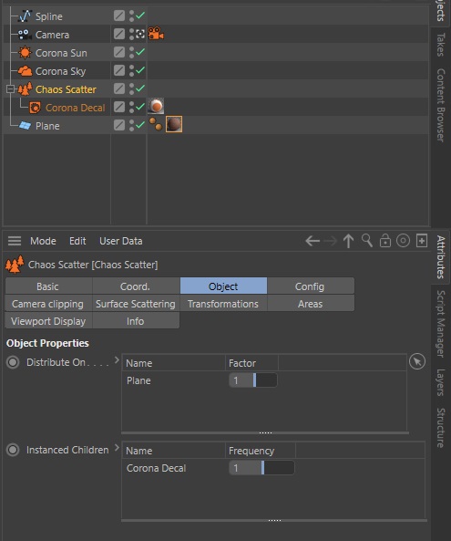

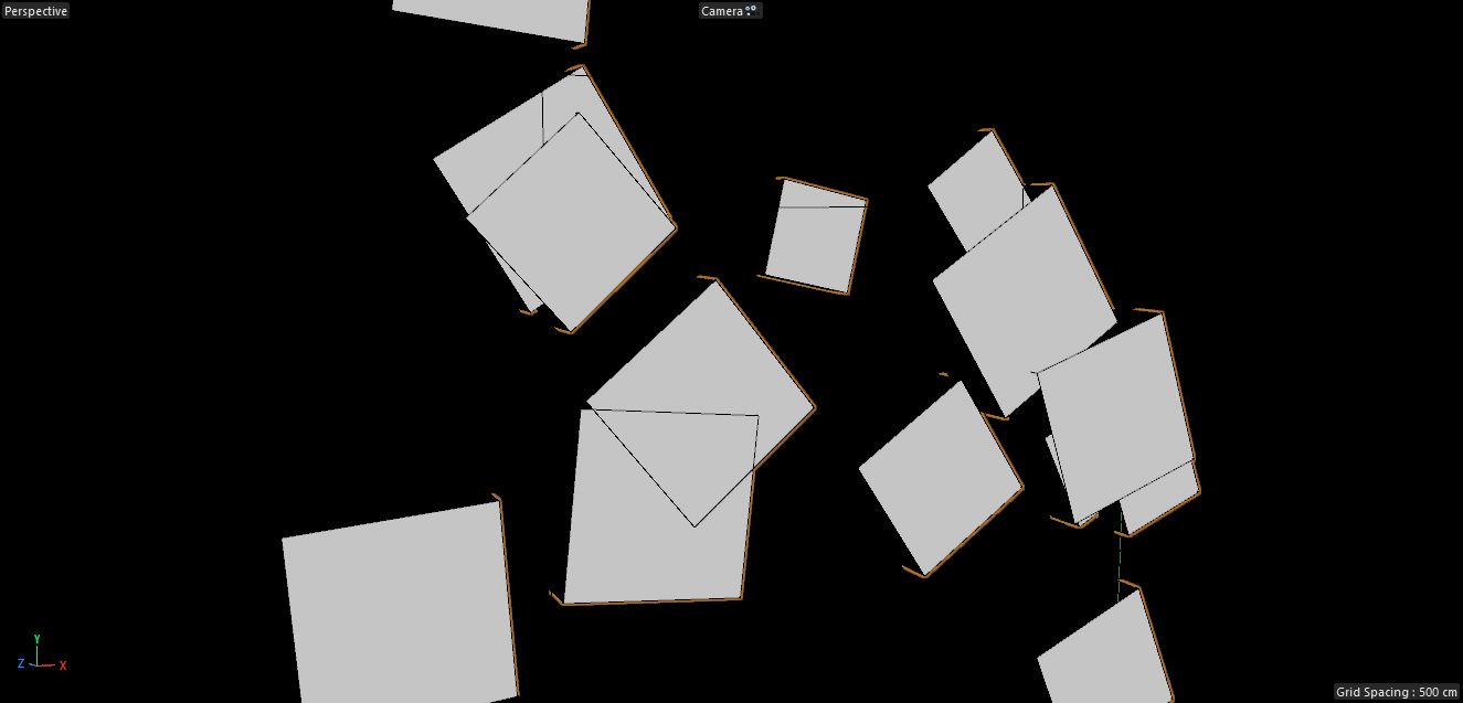

Corona Decals can be scattered on one or more surfaces using Chaos Scatter. This is useful for adding scene details such as graffiti, stickers, puddles of water, etc.
In this example, Corona Decal objects are scattered on a stone wall. The decal material is using a diffuse texture and an opacity texture:
In this example, the Corona Decals are scattered on a surface, creating dents in it. In this case, the decal material is using displacement and self-illumination:

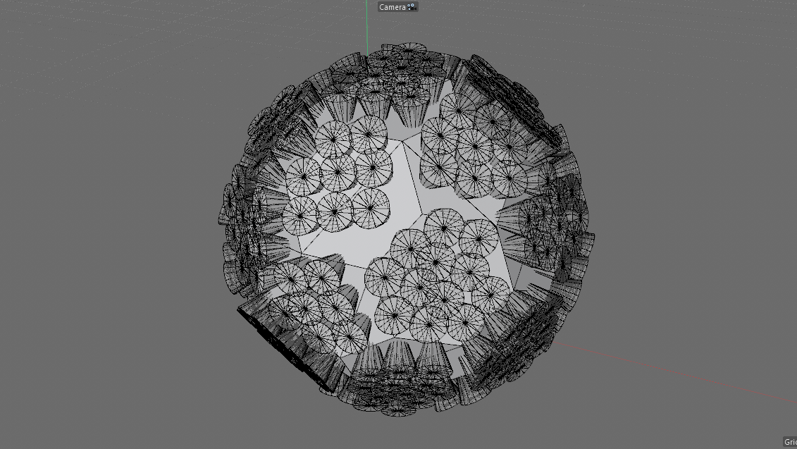

And the other way around - if you apply the Slicer Material to a Scatter, you can use it to cut through other geometry:
Using a Scatter to cut holes on the surface of a sphere.
